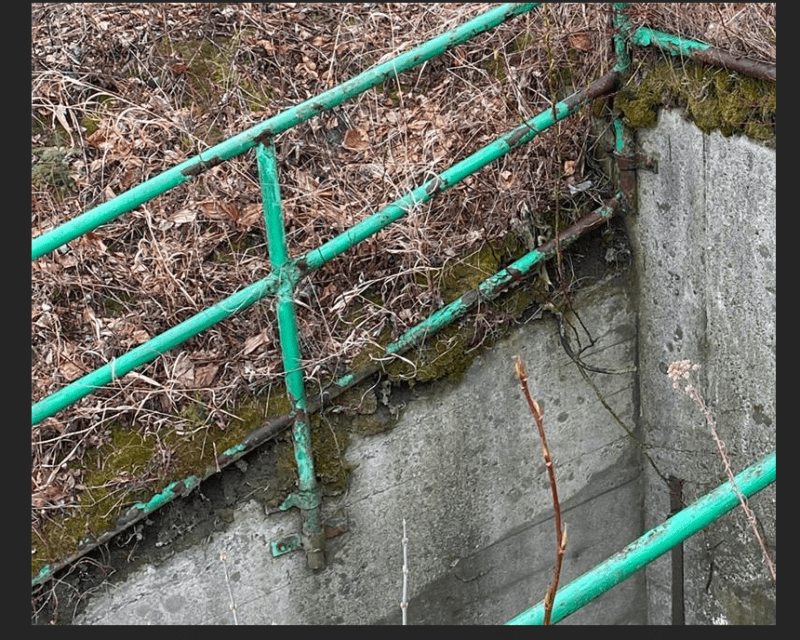

Hello All,
Just checking if anyone has a typical detail for a wall-face mounted guard rail. Something like this.
Weld end of a WT stem to the post, anchor WT to wall.
Like some of these... I have SMath programs for these bases. [pipe]
Check around your area. There is probably a full service railing supplier and they will provide everything including design and fabrication. If you just looking for some details as a reference here is one such supplier Link
