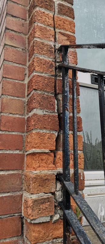

Electrical engineering is my background and need some help with regards to these structural cracks on a house im looking to purchase. I'm not sure if it's cause by corrosion from balustrade, there's no water pipe leaking in behind. Any help is welcome guys and greatly appreciated about cause, remedy and cost.

I would say it's potentially a corrosion of the guardrail issue and quite possible just from the lateral loading that the guardrail sees. How often are people leaning against something like that just torquing on the masonry in a way that it isn't designed for.

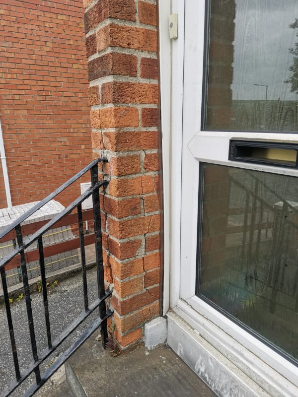

I've uploaded a pic of the house and as you can see it's only at the handrail and doesn't travel up the house however I was worried about potential subsidence. Am I really over thinking this one?
It is something I would address sooner rather than later, but from the information I'm seeing in the couple of pictures it doesn't look overly sinister. Since the cracks don't extend much beyond the handrail in any direction I'd say that is likely the culprit. It almost looks like that brick was added after the handrail install in order to hide the connection of the handrail to the main brick.

Looks like a bad fitup and sun hot black iron in the joint plane didnt help. Grind the rails off and replace some bricks.

Anyways, I think jayrod is spot on. Probably an afterthought and someone applied force to the handrail while the mortar was fresh(ish) + corrosion over time acted as stress risers at solid brick locations. Not a systemic issue. Easy to fix. No problem.
the awning over the door could be potentially directing water to this area, possibly making the cracking and deterioration of the bricks worse

1 other thing I'd like to point out is that the pvc frame is bowing a little due to the pressure from the brick, is this a serious cause for concern?

I just spoke with a local builder. He says it's an easy fix and likely caused by steel corrosion and over the years rain/damp has gotten in and frost has expanded the brick. He tells me it's nothing to worry about but will show on a survey as something that needs fixed.

sounds like you've got good advice. PVC door frame should "pop" back when brick work repaired.

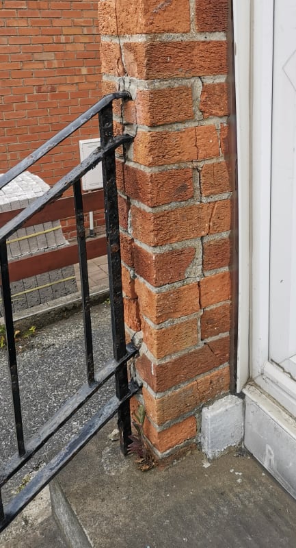

I won't be surprised if this isn't just a small stand alone brick column 1 brick wide by 1 brick deep, but of no structural value.
you would though need to figure out where the lintel goes / rests on for the main door opening as it might rest on top of this pile of rubble.
But I suspect it is purely cosmetic, so long term, just remove the railings and knock down and replace the brick column.
If you can get anyone to do it, it's probably £1 -2K including new bricks.

Realistically it should be one day for two people to do it all and take the rubble away so maybe £500 + bricks, but no one can be bothered with these little jobs atm...
Does the balustrade even need to connect to the brick? It looks like cantilever posts. It
Might be worth trimming the end off.
