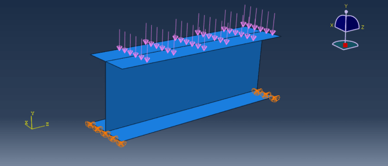

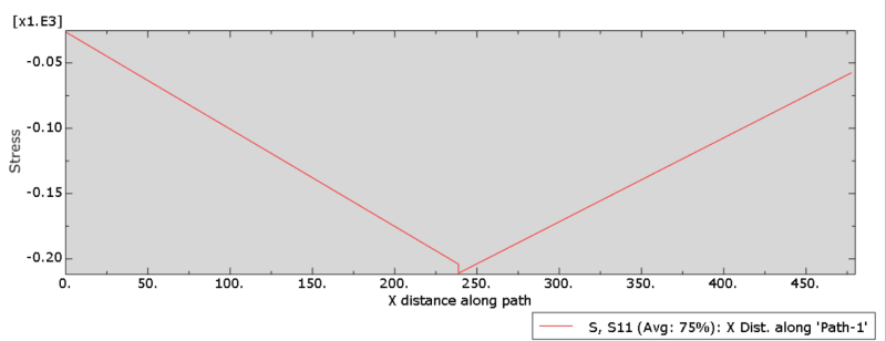

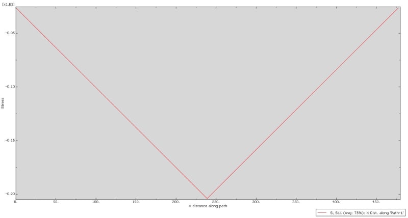

Hi all,I have tried to do simply supported one span I beam under uniform distributed load. Then extract s11 by defining path at bottom flange. However,

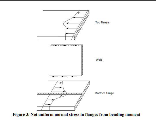

1.The stress in x-dir s11 is not symmetric along flange, there is sudden increase in stress at RHS of middle flange (i understand there would be shear lag effect which cause ununiform stress but the stress along flange should be symmetric and no sudden increase in my understanding)

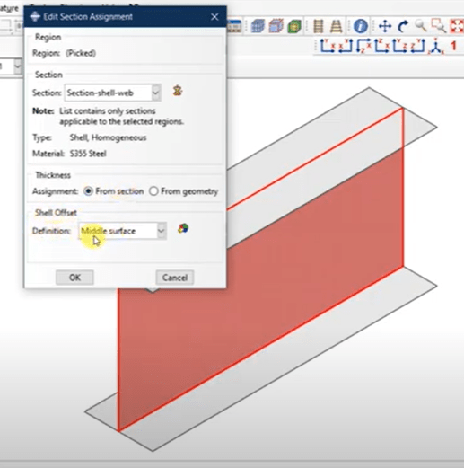

Offsetting the shell sections applied to the flanges should help. Just make sure that normals are consistent first.
Regarding the sketch, I'm not sure what you are talking about. 245+245=490 so it's fine unless you wanted those sides to be 250 mm long instead of 245 mm long. In such a case you can just edit that dimension (before doing that make sure that the sketch is properly constrained).

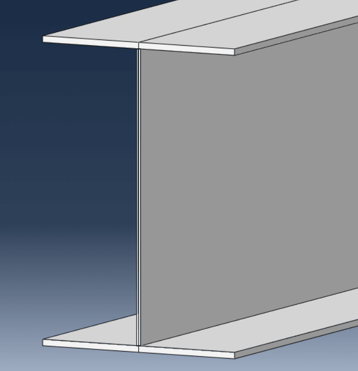

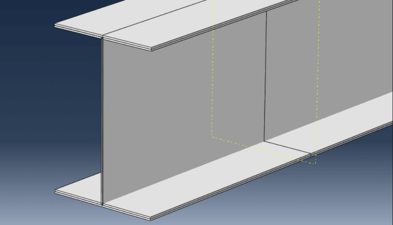

1. When i built up this model, i alreay apply shell offest to create flange and web thickness (kind of like below image)
But i am no sure how to make sure the normals are consistent. Becacuse i kind of new in Abaqus.

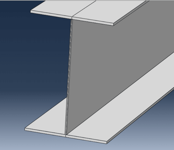

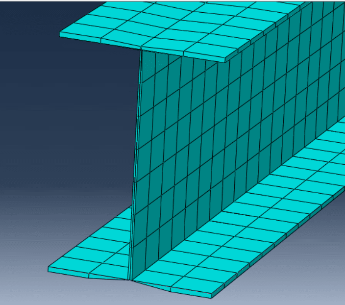

I just wonder there may be something wrong at the joint between flange and web. But the extrude view (see below image) is kind of normal to me.
I made a parition at the mid span so that I can create path and extract stress. I know it is kind of stupid but i dont know if there is proper way to get the stress at mid span.
Offset should be set to top or bottom surface for the flanges so that they don’t interfere with the web. Thickness visualization will show you if it’s ok.

Also I found that mesh in extrude view is strange (taper close to the centerline), i dont know if it is normal.
Well, I get the correct distribution with those changes, double-check your settings.
Regarding that shell thickness visualization - it should be correct if you enable it in the Visualization module.

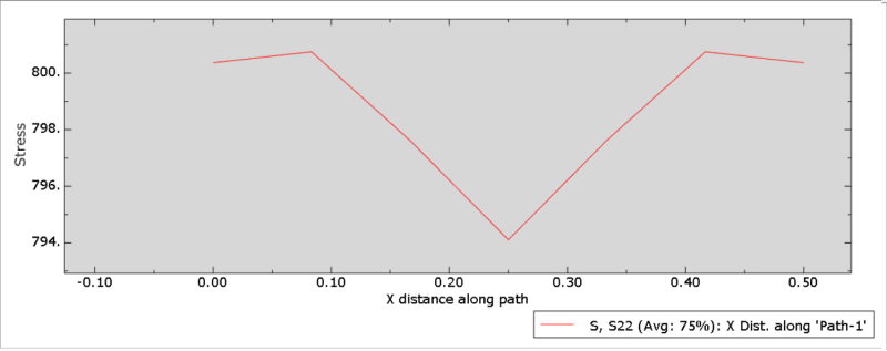

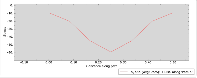

Thanks. I did several trials, finally have the following stress diaphragm
But dont know why s22 stress pattern is like that. Not sure if it is correct or not.

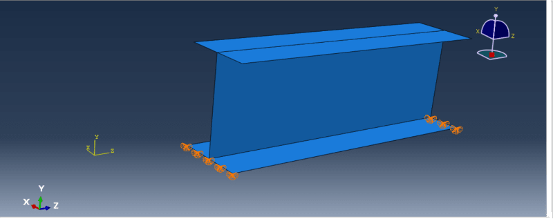

Q1: I found that if I pin only bottom flange vs both top and bottom flange, the S11 and S22 stress diaphragm patterns are vice versa. I just wonder if i want to simulate simply support beam, should I just pin bottom flange like below image?
