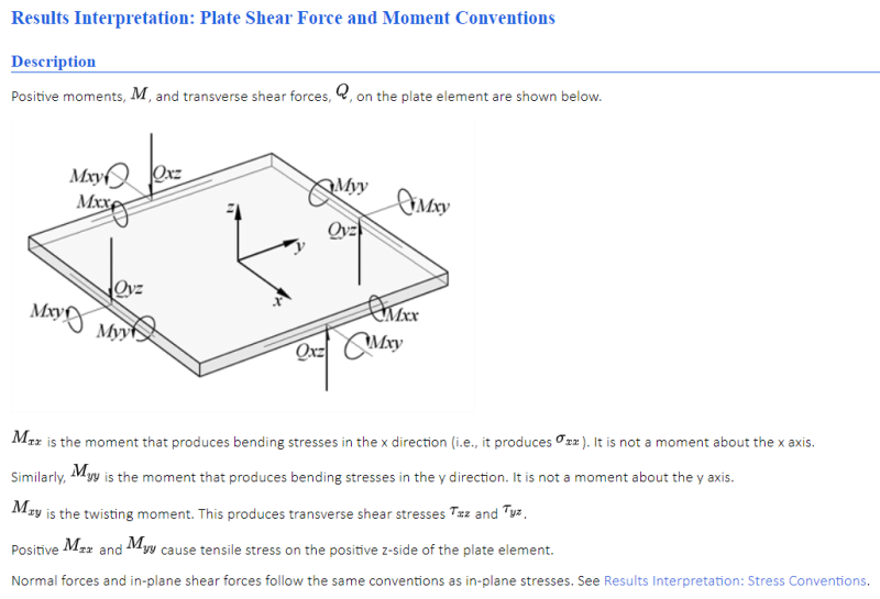

Hi, what direction (clockwise or counter-clockwise) are the positive and negative bending moment values found in the results tables. Results are based on the global axes.

Its just that I'm reading reactions from nodes on plates. so it's a bit tricky to determine what is actually happening.

I use the international convention... an orthogonal right hand coordinate system with the (force direction signs) X (sign values for the face the forces are acting on).
You aren't the only one who finds these things confusing. The diagram below is helpful. It is from the Rel 3 help, but the same applies to previous versions:
But rather than worrying about clockwise or anti-clockwise, I recommend displaying the plates as solids, then displaying surface stress values, so you can see which face is in tension.
