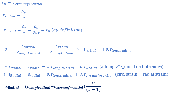

Hello everyone,
I'm analyzing how to measure the strains and obtain the stresses at a pipe using a strain gage (measuring circumferential and longitudinal strain with a rosette), and I was informed that the relation between radial strain and the other two components is the following one:
Someone knows from where this relation comes from and how to derive it?
Thank you.
Thank you @1503-44
From the paper, I understood that the strain equation I mentioned it is just math manipulation. I still don't understood why to use this equation, once I could apply directly the poisson definition and get it directly, since the circumferential strain and the radial one are the same .

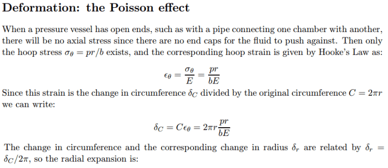

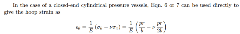

rb1957, I'm not sure if I get you point, but the relation between hoop strain and pressure, considering the contribution of axial stress is given by:
from the link provided by 1503-44.
In this case seems that they are considering a plane stress state and later on calculating the radial strain as a consequence of hoop strain.

The circumferential strain and radial strain are not the same. I think you noticed that the pipe diameter increases proportionally to the circumferential strain so that's why you made that assumption, but it is not correct. Radial strain results in the thickness of the walls of the pipes changing, not the diameter changing.
For thin walled pipes, you have circumferential and longitudinal stress and a negligible amount of radial stress that is assumed to be zero. This means your strains in each direction are:
ε,longitudinal = σ,longitudinal/E - ν*σ,circumferential/E​
ε,circumferential = σ,circumferential/E - ν*σ,longitudinal/E​
ε,radial = -ν*σ,circumferential/E - ν*σ,longitudinal/E​
Solving these equations will give you ε,radial = ν/(ν-1)*(ε,longitudinal + ε,circumferential)

I also have a problem with that model. What pressure vessel has open ends?
And fluid in a pressurized pipe connecting two chambers together pushes against the fluid in the chambers, which in turn push against all walls in the chamber, which in effect forms "chambered end caps". A pipe's internal pressure does not care if there is a blind flange or a chamber fixed to its ends, but if there is no resistance to a pipe's internal pressure at the pipe's ends, nothing attached, how can a pipe retain any internal pressure at all. The fluid would simply flow out the ends and internal pressure would be zero.
In a very long pipeline, the pressure at one end is the inlet pressure, say 100 psig. The pressure at the outlet 1000 pipe lengths away is 10 psig, because of friction generated by flow in the pipe. The friction is transferred to the pipe wall by viscous forces, thus the pipe wall stress (Poisson stress) gets carried down the pipe, some resisted by soil embedment forces, and eventually what's left of that combines with the fluid pressure at the outlet, to push against whatever pressure the fluid has at the pipeline's final exit conditions. There is in reality no "open ended pipe" anywhere that has no resisting pressure at its outlet, unless the pipe empties into a complete vacuum, 0 psia, but even that just means that the pipe wall stress plus internal pressure also equalled zero when precisely as it gets to the end of the pipeline.

thank you you made my point. the 2nd post etheta (pointing to 1530-44's link, which I didn't open) is different to the first post you sent (where, under "deformation - the Poisson Effect" you have etheta = pR/bE).
@rb1987, yes, the situations are different (PV with closed or open ends) and that's why the etheta changes:
1st post) a pressure vessel with open ends, considering no axial stress.
2nd post) a pressure vessel with closed ends, taking into account also axial stress contribution.
In any case, if you check the document provided by @1503-44, everything is well explained. Also in his last post there is some information about this open ends pressure vessels.
