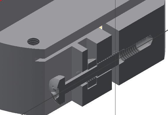

I'm struggling here. I have a clamp which will be tightened over a rod. The clamp and rod will be enclosed in a box and the thru hole you can see in the model will not be easily accessible. I'm trying to think of ways to fit a captive screw in this thru hole so it can be tightened from outside the box. I'm trying to look up information on typical captive screws, but all the information I find only references sheet metal. Can captive screws be fitted to machined blocks?
Failing that, what other methods can I use to have a screw in this through hole without it falling out? I want it idiot proof so someone won't fully loosen it. One idea is a seperate sheet metal plate fixing onto this area with it's own captive panel screw, but that seems inelegant.
If you mill off the threads along the top 1/3rd of the screws, sliding an e-clip over the screw between the two compression faces would prevent the user from removing the screw completely...

I would be worried about stripping the thread ... tighten with a torque wrench ?
could you reverse the whole thing ? have a stud on the body, and tighten a nut ?
I think this is what I might go with. I have been looking up all sorts of unique and interesting methods to retain it. Dropping a plate down with a shoulder screw to retain it, putting a thread at the end of one hole as a sort of stop and captive washers.
I think the easiest solution is to just drop a nut down and using a shoulder screw.
I could reverse it, but my only worry is the stud coming loose (Unless I put tons of lock tight on it.
I wouldn't tap the bore ... use a threaded insert, and step the bore (so it's easy to install the insert) or have a flanged insert.
My e-clip idea is essentially what you've shown, Z, but mine has the benefit of not requiring any further machining to the block (the clip goes into the pre-existing gap). I think you're thinking too hard on this one...

Actually yeah, an e-clip is the easiest and simplest solution. Quick to install and requires less work.
I will go with that, thanks!
We have a cheap gasketed box we have made by a local shop, they use an o-ring instead of an e-clip to retain the fastener. Reason is that you can squeeze the o-ring back through the hole by grabbing the screw by the head with a pair of pliers and giving it a yank. A bit easier than trying to extract an e-clip buried in the slot.
