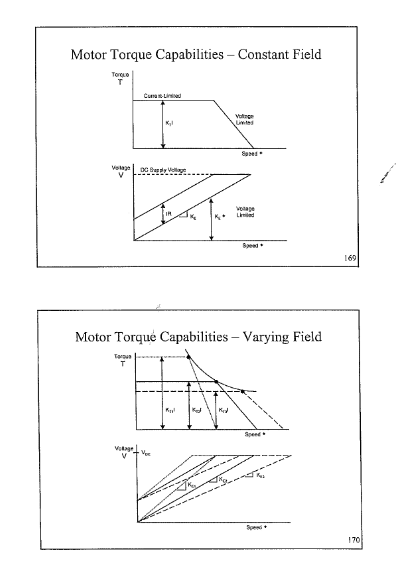

sreid:
Here are the plots I have used in the past to explain these limitations to students:
On the "Constant Field" slide (all we will consider here), I show the torque/speed diagram that people are used to seeing, especially for DC motors. Below that I show the matching voltage/speed plot that "explains" the torque/speed plot. The lower line on this plot is the Ke*w back EMF. The gap between it and the upper line is shown as the "IR" drop, but in the more general case includes the L*di/dt voltage as well.
You are correct that you cannot get as much acceleration when you approach top speed as you can at low speeds. In the past, I would see it recommended to use a parabolic velocity profile if you really wanted to maximize your acceleration to top speed. I think now most people use an "S-curve" velocity profile instead for the sake of smoothness when starting, but keeping the parabolic velocity profile (decreasing acceleration) as maximum speed is reached.
A couple lesser points:
The difference between your linearly modulated amplifier and the more common pulse-width modulation is not important for this behavior.
If you are using a 3-phase servo-motor amplifier for your 2-phase stepper motor by tying two of your motor leads to the same amplifier output (quite commonly done), your effective bus voltage is reduced by a factor of 1/sqrt(2), so you really have only 70% of the bus voltage available.
