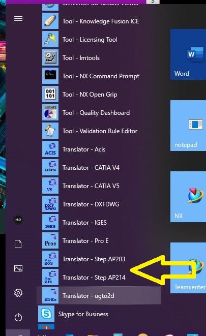

Have you considered using the built-in translator that NX has in Windows ?
You will need to expand the Siemens-NX menu to get there.
Jerry J.
UGV5-NX1884
I am aware of this, but learning this has other benefits for me as well, therefore, why not use this as an opportunity to learn how to do this? In the future, I may implement the batch file to not only convert the file, but to also convert from millimeters to inches in one go.
