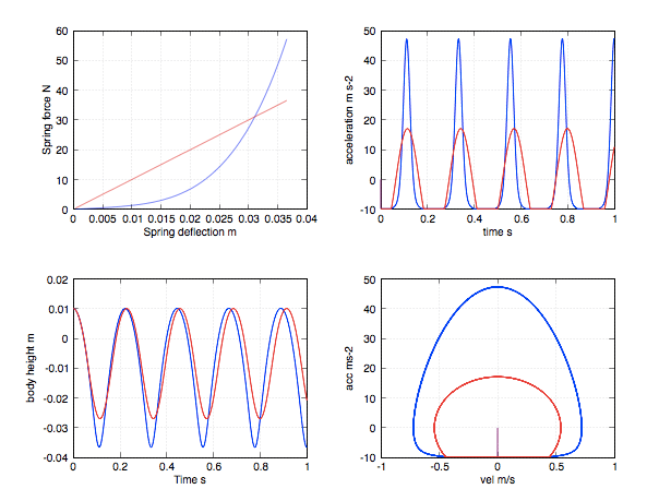

OP- ah ok. Well the great news is I have worked on that very problem. What frequency response does a non linear spring give in an SDOF?
The bad news is that I use numerical methods, and having done it I didn't try and derive any rules of thumb.
In this case the mass is bouncing off the spring, rather than fixed to it.
script attached, it's written for Octave, if you have riches beyond the dreams of avarice then to convert it to Matlab change endif to end.
Cheers
Greg Locock
