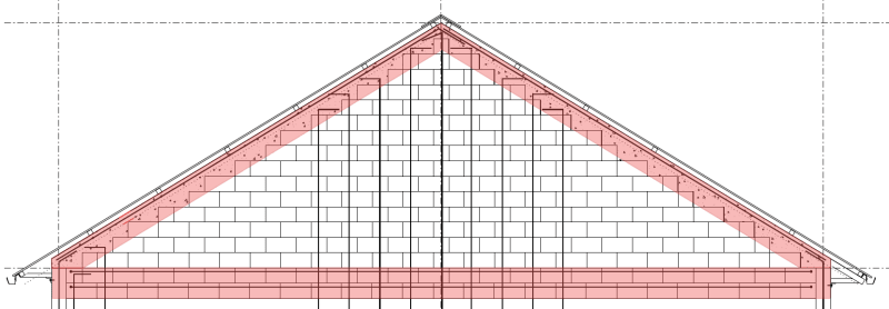

Also the end walls of the structure in the short direction are masonry gable walls - so any advice on how to connect the end purlins to these end walls would be appreciated as well to ensure a desired load path to shear walls? (Ie rake beam details or etc).

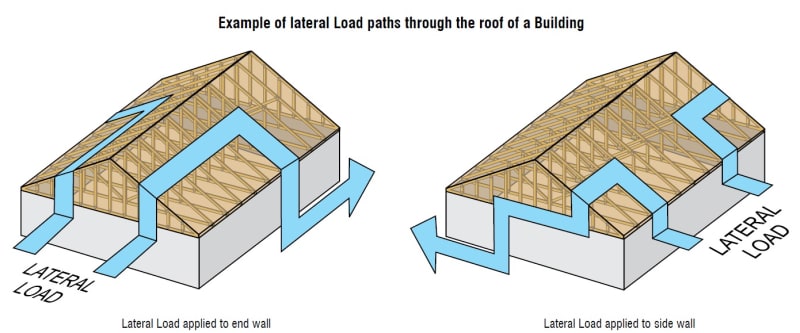

Honestly, I think you need to study how buildings work. For wind perp. to the ridge, your diaphragm takes 1/2 of the wall wind pressure and all of the roof wind pressure. This is transferred into the gable end trusses as a shear. I would try to find some online videos and also start using a pencil and paper instead of MathCAD or whatever else you are doing your calcs on. It is unlikely that you have any bolt shear issues on this building.
Going off of ENG16080 - I agree with him that the roof diaphragm acts like a big beam with its supports at the gable ends. Those gable end trusses should be drag trusses that transfer the shear to those gable walls. Google "Drag Truss" and you'll get some good info.

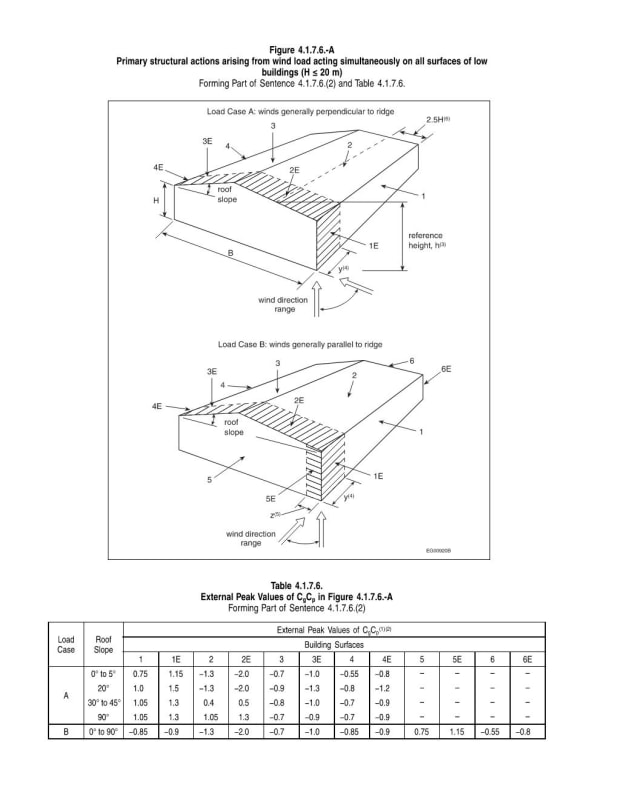

Also, I see your wind force is the same and acting in the same direction leeward and windward. In the NBCC (Canada) we have it so that in low pitches the forces are always uplifting on the roof and on higher pitches it is sucking on one side and blowing on the other. And leeward typically weaker than windward, see link. Maybe a second look at your forces can reduce the demand on the system.
Thank you all for your helpful responses. From this discussion, I am in agreement that in theory, the roof diaphragm should transfer the force to the gable end walls. My main question now is how is this force transfer facilitated (ie through what connections?).
The end gable walls are masonry walls, not trusses (drawing shown previously was outdated). These would be my "Drag Trusses" (per Torchman's response). I agree that each of the 10m walls in the short direction will take half of the force at the roof diaphragm level (Vu), shown in my attached calc. At the gable wall, I plan to have the purlins from the last trusses framing into a rake beam (picture attached). How do I determine the reactions from each purlin onto the gable wall? Is it just the shear force (Vu)/# of purlins? What does this connection typically look like in a steel truss to masonry wall system?
Essentially yes.

Correct typically deck is fastened to the blocking and the blocking is fastened to the wall. What material is your roof deck?
Typically there should be blocking to provide a direct load path between the roof sheathing and the wall. For this type of construction, I would use the top course of the cmu wall (bond beam) to serve as the diaphragm chord. You would need to provide longitudinal rebar in the bond beam sufficient to resist the chord force (in tension). The chord forces would be transferred through this blocking and not through the truss end connection. If you were to do it that way instead (without blocking), I think you'd find that the shear forces at that connection are excessive. Perhaps you can use a purlin aligned over the wall to function as blocking assuming the purlin can somehow be connected to the wall.

All, it looks like the key component I was missing was the blocking and its effect in distributing the lateral forces from the chords to the shear walls. The end truss connections actually will not be experiencing the wind lateral load. Instead, I will design them for the seismic force in the short direction, which is presumably much less. The end purlins will be made continuous along the length of the building (via welded splices) and will be designed to take the axial load from the chord force of the diaphragm.
I will have blocking beams on top of the rake beam (in between purlins) where the roof sheeting is fastened and it will take the shear force from the diaphragm to the masonry wall.

It may be easier to use a steel diaphragm chord - such as a bent plate or cont. purlin instead of forcing the load thru a bunch of blocking into the bond beam.
