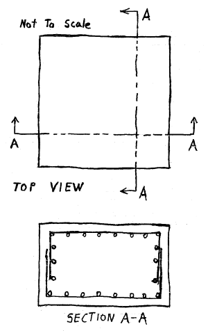

As shrinkage starts on the concrete surface, the reinforcement you are calculating is temperature and shrinkage steel to minimize the width of those surface cracks, and prevent the cracks propagate deeper into the concrete block. The reinforcement inside of the block can be considered as a waste, since the surface reinforcement is much more effective in doing the job.

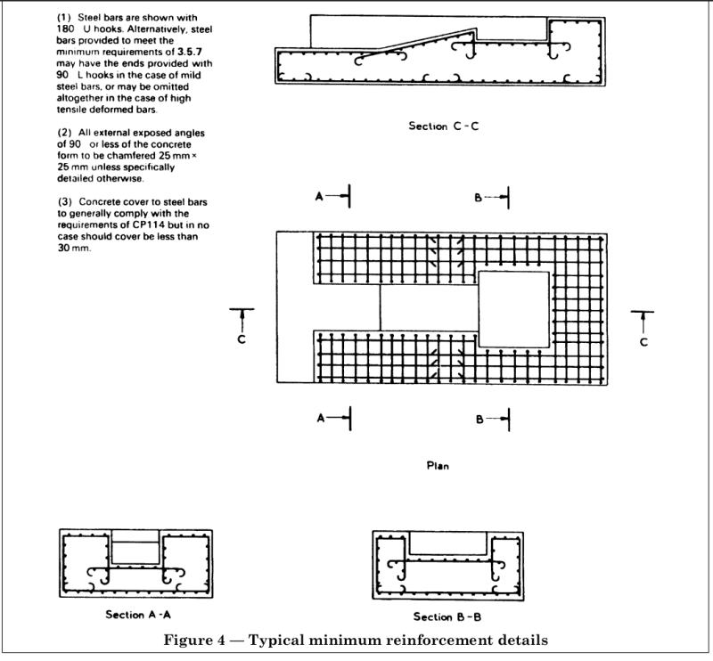

If you foundation is for a small machine the vibration characteristic could be modelled as rigid body movements in 6 modes by analysing the effect of the soil. A very good and practical guide can be found by Bristish CP 2012. Above that you may have to do a 3D finite element, 2D plate or a comination of plate and frame to model the foundation sitting on elastic springs for the soil.
From my own experience I always recommend 3D cage as described by CP2012 as it does provide a continuity to pass the holding down bolt stresses into the block and justify the rigid body coupling concept. The 3D cage is additional to the surface reinforcement at all sides. Your block should finished with additional trimmers at corners, holes and cutout where stress changes suddenly to control cracks.
A non-performing machine foundation never collapses structurally. It just cracks and fails to damp down the vibration resulting more than normal outage for maintenance and parts replacements. Many machine vendors install vibration sensors to monitor the performance of their products. You could void the warranty if the foundation fails to control the vibration within a set threshold. Such threshold typically sound an alrm and then ultimately trip the equipment.
Some machine foundation drawings
A GT foundation
Another GT foundation
CP2012 Fig 4

so the steel reinforcement only near faces no intermediate layer needed.
my block foundation is 23' Long 15'Width 5'Thick

You have to ask yourself why you need to provide temperature and shrinkage steel, and at what location the cracks are most likely to occur, if the free of load block is left unreinforced. Also think about why the code name it "temperature-shrinkage steel", not "temperature-expansion steel".
