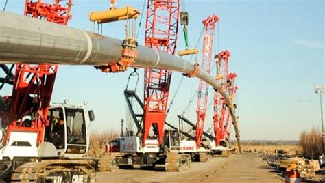

The spool 1200 ft is prepared and laid on roller supports and lifted some portion with sideboom cranes( while remaining still on the roller supports ).

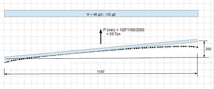

The sketch below just to show the magnitude of this task as described.
[Correction] P(min)= 60 Tons
I don't think this the way how Directional Drilling does.
P KANDEL
You're doing this all wrong.
10 degrees is too big as an entry angle. 5 to 7 is more normal to avoid a huge height of crane
The pipe should be a curve of around 500 D min to avoid overstress and buckling. For a 36" pipe you probably need a support every 50 to 70m.
You need to contact some companies that do this for a living to avoid making some huge errors. IMHO.
You can have a snake configuration with forward and reverse curves
Its not lifted as a straight pipe.
