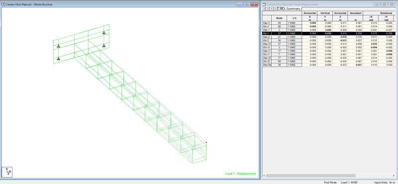

I Attached the STAAD Model I did so you can see what happened and what did I do so you can give me your feedback
The line load is approx 10 Lb/in downward
The stresses increased on the upper bolt row as seen in the model and the plate is not considered as 100% fixed connection.
the deflection is around 0.67'' at the edge of the cantleiver ( Thats a canopy btw and every thing is ASD)

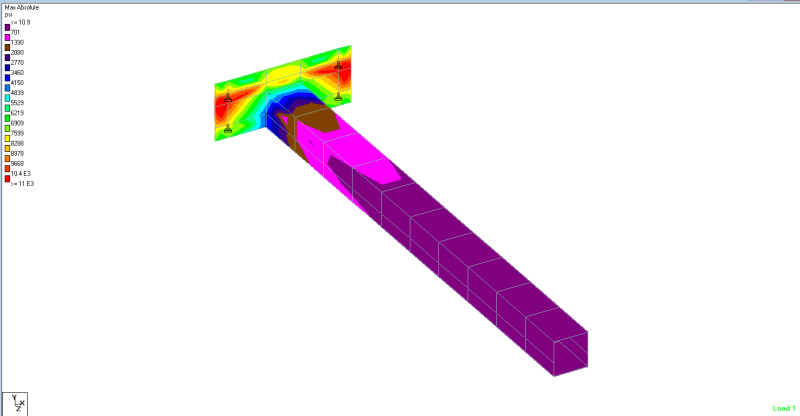

The bolts may pry which causes changes in your plate stresses and bolt forces.
Is this a stress diagram, or force diagram?
Then why the stress does not vary with beam depth?
It does, it's just that the stress in the entire member is so low (especially near the end) that it's all the same color. If the color gradations were finer the change in stress would be more evident.
JLNJ,
Thanks. It makes sense.
