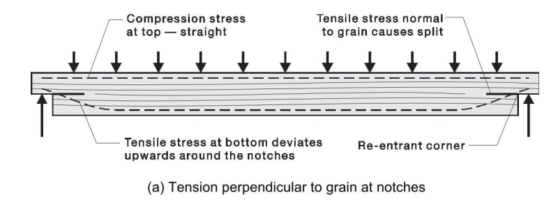

For the hanger force and end moment, someone must have looked at it as it would be the starting point for the timber notch fracture mechanics. For example, something like the hanger force is shown indicatively in a timber design handbook published by Standards Australia (below), and I think it is intuitive if you assume that the stress in the reinforcement develops fairly quickly as per the other discussion.
