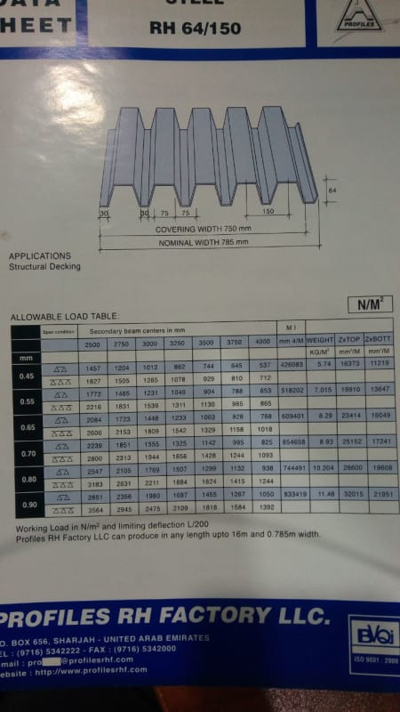

I have this catalogue showing the allowable working load for different profiles

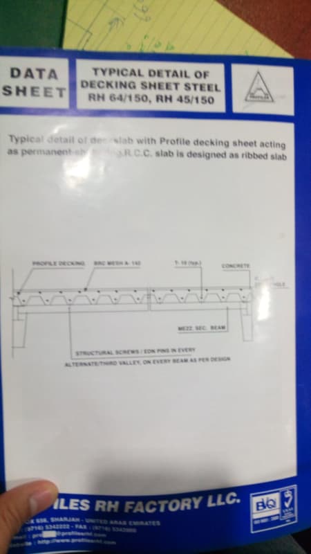

and they provided a typical detail of composite slab deck
. Can someone give me any design reference to verify these values using BS? ACI? I need to check a Steel deck profile (45x150x1mm) + 100mm (overall height of slab) with A-393 mesh but doesnt have a bottom steel reinforcement. Is the bottom reinforcement really a necessity in this kind of detail?. Thank you in advance
