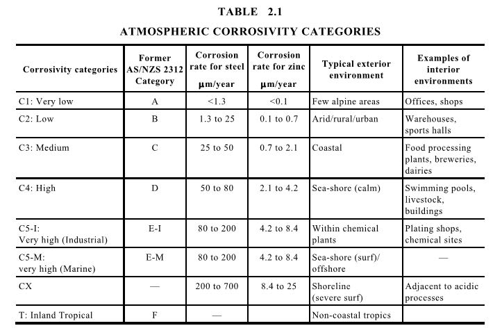

As per the earlier responses, it depends. Here are some guidelines from Australian Standard AS 2312. It references ISO 9223 which would probably be more acceptable internationally than an Australian Standard if you want to look into it.
Not sure whether your high-strength steel is more susceptible than more typical steel grades. Is it for bolts?

Note in relation to the AS table above, the current version of ISO 9223 on which it is based, does not include the T class that is unique to Australia. Also the C5 condition is no longer split but is just C5. Remember the rates in the table are for the first year of exposure, look in ISO 9224 for how to deal with long-term rates. The data is for samples fully exposed to the service environment and takes no account of localized effects. For a pin corrosion risks are more than likely controlled by local effects resulting from the pin details than the general case.
