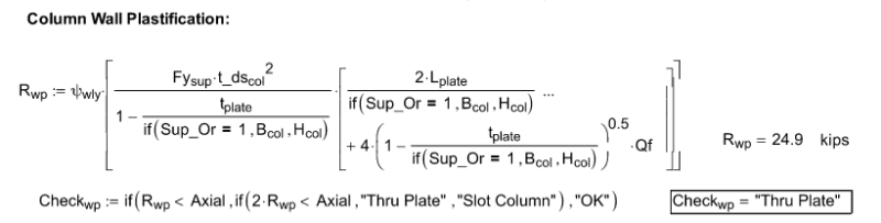

Steel Connections: Through-plate vs Slot Column?
Ben29
Aug 7, 2014
334
Someone please school me. I didn't know there was a difference between these terms. But I came across this "HSS Wall Plastification" calculation whereby if the "thru-plate" doesn't work, then you should "slot column"
