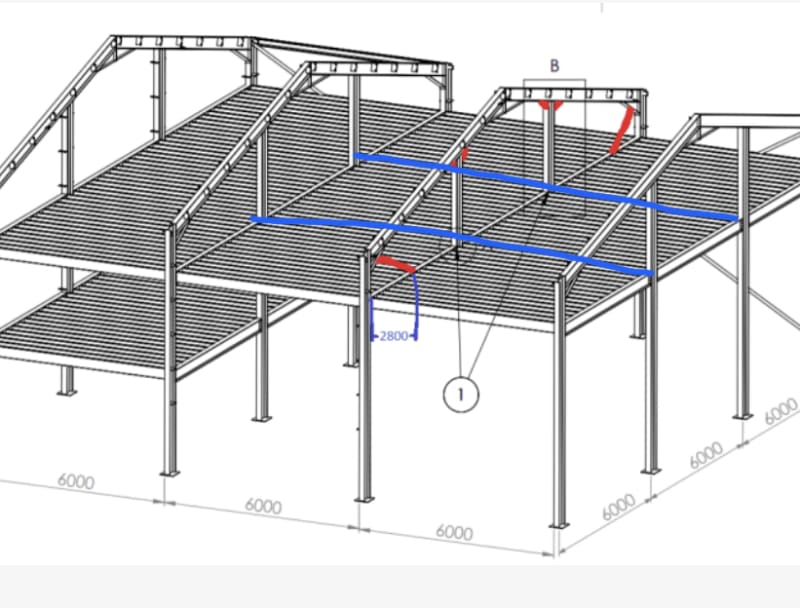

I am now designing my own building, it is to be 18mx18m 7m to the eves consisting of 3 6m bays. 1 bay is to consist of 3 floors of office, storage and assembly space.
Up to this point, quite simple, however, I've had the thought of extending the 2nd floor over the entire 3 bays, but I would like the 2 workshop bays free of pillars/columns. So the idea is to simply have 1 set of beams to be supported from columns attached to the rafters.
I'd appreciate it if some of you could look at the attached drawings and let me know if this is feasible depending on section sizes.

In theory, what you are thinking of doing is not that much out of the ordinary but it would definitely require a structural engineer to design both the overall structure and the connections.
What is your lateral force system? I'm not seeing one.
Certainly doable. 356 UB’s won’t cut it though over an 18m span. But there’e nothing wrong with the principle of hanging from the roof once it’s designed accordingly by an engineer.
Personally I’d also consider roof trusses which might cater for the point loads better than a portal.
You’ll also need eaves beams, ties at top of hangers, roof plane bracing and perimeter wall bracing for lateral stability.

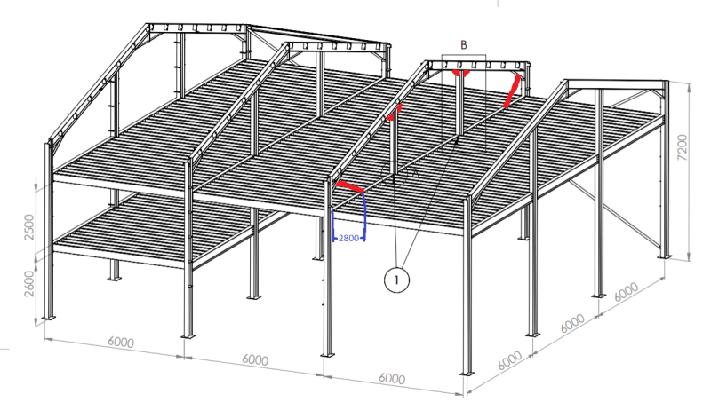

The third portal frame will suffer ... I will suggest the use of full height ( in this case 3rd storey ht ) truss rather than hanging the 2 nd floor to roof beam with tension elements..
Similar truss can be seen at Ferries at passenger deck..
Agree with HTURKAK. For economy, use a truss on the two middle frames. (See red diagonals in attached sketch)

The truss design as suggested BAretired would limit the floor space far too much, the upper floor is to house an assembly line which requires the entire length of the building.
I can't see why any additional bracing would be required on portal 2 as the inner columns continue to the ground floor.

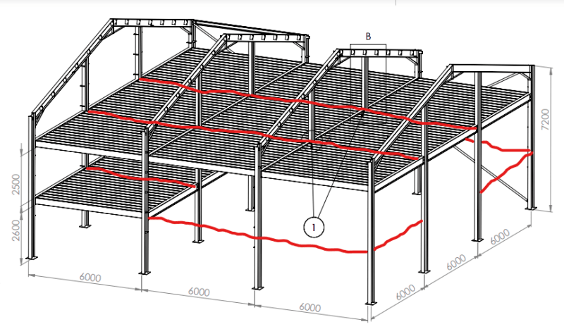

I could add bracing as shown here:
I think using larger or tapered columns and rafters on portal 3 is an option.

The OP uses moment frame in one direction, and braced frame in another direction. I don't think truss is required under the roof, which may be intended for storage. Two secondary floor beams under the one level columns should work.
As a simpler alternative, how about a couple of floor beams spanning the 12m? Nice and easy.
Sorry, I should have noticed that the columns on Portal #2 continued down. So the only problem is on Portal #3. I don't think knee braces would be enough. The beams shown by MIStructE_IRE may be the best option.

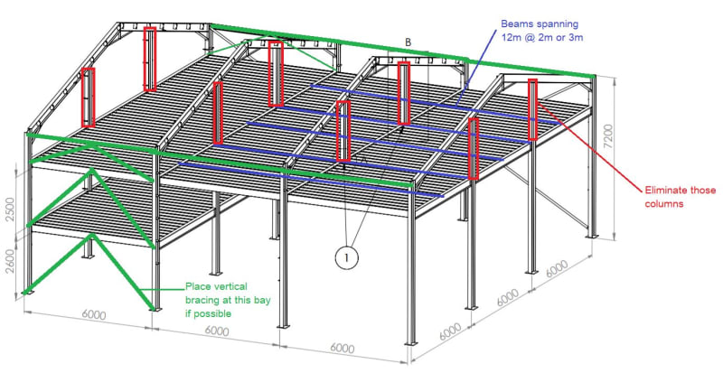

I am with MIStructE, that is the best and easiest solution. 12m beams @ 3m or 2m (depending on the steel deck) seem very feasible to me. If height limit is a problem, you can use joists or castellated beams to accommodate the duct work and increase the available space. Also, I would remove the columns above the second floor and let the rafters span 18m.
This is the way I would do (bracings and ridge/edge beams not shown). Leave one open bay for overhead door.

PROYECTOR said:
I am with MIStructE, that is the best and easiest solution. 12m beams @ 3m or 2m (depending on the steel deck) seem very feasible to me. If height limit is a problem, you can use joists or castellated beams to accommodate the ductwork and increase the available space. Also, I would remove the columns above the second floor and let the rafters span 18m.
I like this option very much which is probably what I will go with subject to proper calculations etc. Like I said I need the top floor to have an uninterrupted 18m length of floor space and the ground floor 18x12m workshop space to have no columns.

Tezza91 said:
Eaves beams: Are you suggesting I need UBs at eave level or just the typical 2mm cold rolled eave sections?
I just suggest that the top of the columns need to be properly braced. The elements used for that purpose (being a cold formed or a hot rolled section) need to be properly designed and connected to the roof diaphragm.
