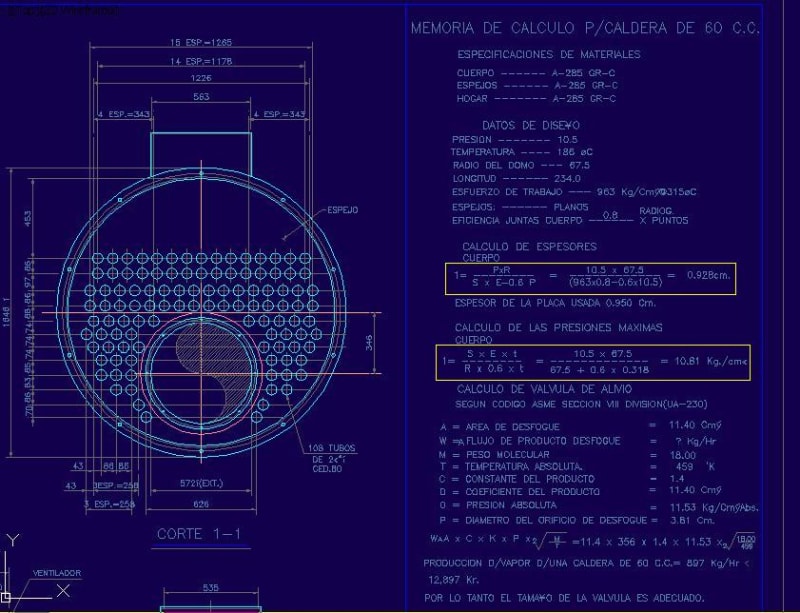

I found a drawing of a steam boiler (506,160 KCal/hr) (fire tubes) and I'm interested in check the max pressure and/or design pressure this steam boiler can work with, also I would like to check the size of the relieve valve, can you recommend me some literature/code where I can find the formulas for this?

attached is an image of a part of a drawing I'm taking as an example,this drawing include a set of ecuations to obtain the thickness and pressure of the body of the boiler, I want to do the same but I need to understand where those ecuations are coming

ASME Section I is the Design Code which send you to the references codes as - Section II, V, IX, B31.1 etc.
But, in order to design a power boiler, one shall start with Section I.
luisss749,
The two equations that you mark are from Section VIII Division 1.
