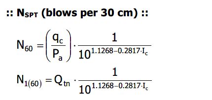

Your talking about qc, which is tip resistance for a Cone Penetration Test (CPT). Below is a correlation based on Ic (soil behavior type). There are some rules of thumb like qc divided by ,2,3,4,5 etc. But its better to base it on material type.
Dont call it a penetrometer test as makes people think of a Dynamic Cone Penetrometer (DCP), or Mckintosh Proble, or TRL probe or Scala penetrometer, which has many names.
