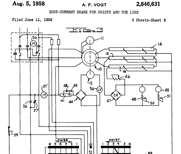

Most of the overhauling load on wound rotor hoists will wind up in the eddy current break if the crane is set up correctly. The eddy current break will not eliminate regeneration.
Keith has a good idea, changing the hoist drive to inverter style might be simpler than dealing with line regeneration to a generator or load bank. You do not "have to scrap" the wound rotor motors, to run them with a VFD. The rotor circuit just needs to be set to a constant value. Consult with the drive manufacturer to determine the fixed resistance needed.
Wound rotor / eddy current hoists are mostly obsolete for new cranes, but are common for older cranes. Here is the patent from 1958.
