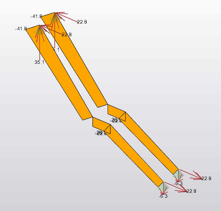

Hi Everyone,
It is my first-time designing stair stringer beams. My model is as shown below. I have upward reactions at the bottom supports and downward reactions at the top supports. At first, I thought that something is wrong with my model so I sent my model to the software support team. They told me that my model is correct and the uplift reactions at the bottom supports are due to the slanting profile of the stringer beam.
I always thought that stair design is similar to one-span simply support design. Why are the reactions uplift? How do I analyze/derive to get those uplift forces? Can't figure out. And the bending moment at the centre of the stringer beam is also zero.
Thanks.
I disagree. I think there is either something wrong with your model or your loading is applied in the wrong direction.
Lean a ladder against a wall. The base of it won’t float up in the air.
Can you post an image of your overall deflected shape?
Could you be getting uplift because you have it pinned pinned? Either the top, or the bottom should be considered a roller in the horizontal direction.
Based on the image, there should be no uplift. As MIS noted, check your model loading.
Are you reaction vectors pointing up at the bottom and down at the top (for the vertical direction)? If you have pinned both the top and bottom, you probably will get tension at the top and compression at the bottom. You need to release the gravity degree of freedom at the top and your stairs will act like columns. I bet if you look at the axial force diagram in your output it will go from tension to compression (like two triangles).
I typical try to design my stairs as beams and have all the horizontal load go into either the top or bottom supporting memeber, and not have it split between the two levels.
where is the load ? somewhere between the two endpoints ? then both reactions are up (loads are down). how can it be other ?
how is this different to a ladder ? If the ladder overhangs the top, then the load can be outside the two reaction points, and the lower load can be up.
But if the load on the ladder is between the two reaction points, both loads are down. It is a three force body, the three forces make a triangle.

I suspect that your model is behaving as it is because, in the absence of the roller that jayrod12 mentioned, your setup is tending to act like a rope. See the sketch below for a simplified version of something similar.
Thanks for putting my thoughts into a picture Koot. That's what I was envisioning happening.
If I'm being honest, this "mistake" is one of the most common ones I come across when working with other designers. Boundary conditions being incorrectly applied cause models to do some funky things. There have been times where it wasn't caught at the stage the OP is at, but rather once the building is already under construction. When it's caught as early as the OP's, it's less of an issue.

Struggle67:
You are inducing tension in the stringer because you don’t have rollers in the horiz. direction at the bot. reaction. That’s about what KootK said, in another way. And, that is showing up as an upward force at the bot. reaction, along with a large horiz. force/reaction. Also, cranked beams can do some really funny things when you induce axial loads in them. They can induce moment components opposite of what you would normally expect, through the cranked region.
I think you need a roller at the LH support, so that you generate only horizontal reaction here.

Thank you so much, everyone
I run my model with one roller support. It looks fine now & reactions seem reasonable (no more uplift).

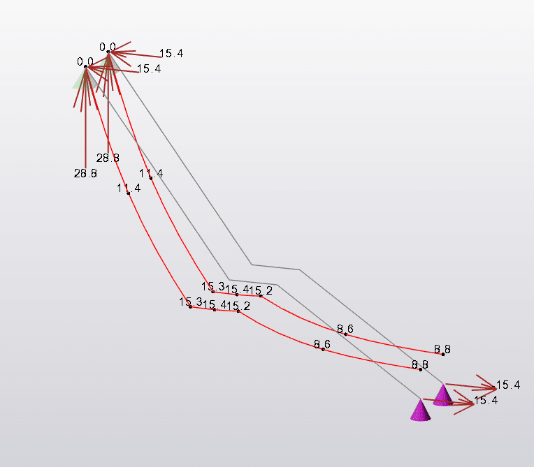

I understand that it is not logical to have uplift at bottom support but is it totally wrong to do pinned-pinned conditions or it is still correct but I will just see weird results/reactions. I am just curious because my actual bolted connections at both ends will have some degree of horizontal restraint.
Remember that idealized support conditions have infinite rigidity and strength, even “pinned” connections.
Just a little flexibility at the connection changes the nature of the structure’s action and reactions. Your connections likely will have some inherent flexibility.
You might also check that your forces are applied about the global and not local axes. Many times this does not make a difference unless the beams are rotated or sloped.
Look at the deflection at the roller. If it's a tiny deflection, then the model is reasonable. If it's a larger deflection, then you might need to put some amount of fixity in there. The tricky part is deciding what is tiny and what is large. That will depend on how things are connected and what the two supporting points are.

OK.. I stand corrected! I've modelled this (ballpark!) using the same software and get the same anomaly. As you can see below, both stringers are in tension so I'm inclined to go with Koots rope theory. Interestingly, the last image below indicates the same model but I've removed the vertical support element at the base - so the bottom defies physics and floats 8.8mm up in the air...which I don't believe is realistic. If it is, then I'm going to make a fortune showing this trick off at Hogwarts school of magic. Any thoughts?
I disagree that this should be modelled with a roller support. Unless your connection behaves like a roller then it you are being disingenuous to model it with a roller support.
(Sure we make many simplifying assumptions in our analysis but this should not be one when we can so easily model it otherwise.)
@human909, but a pinned support is as much a simplification as the roller. the pinned-pinned constraint over-constrains the beam as the two end points are not allowed to translate, as noted above even by a tiny amount.
if pinned-pinned predicts uplift at the lower support, then I say this is Wrong. if pinned-roller gives more believable results then this is definitely Better.
the most correct FEA would have a finite stiffness constraint at both ends, a flexible pinned connection if you will, which will permit tiny deflections. But this is "unnecessarily" complicated for a stair stringer, where modelling as a "cable" is a "gross" simplification, IMHO.
