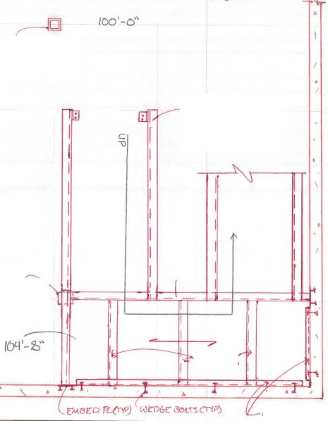

When drawings stairs, do you show everything above a floor in the plan view? I.E. a 3rd floor stair plan would show the structure at the floor, plus the stringers, landings, etc up to the 4th floor?
For a multi-story switchback stair, we usually show 2 landings and half a flight of stairs above and below.
Common to take your plan section 1' above FF... shows a little going up and most of the down... in my experience.

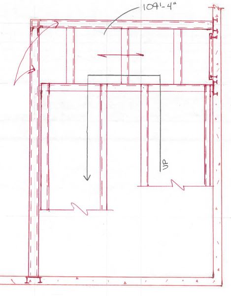

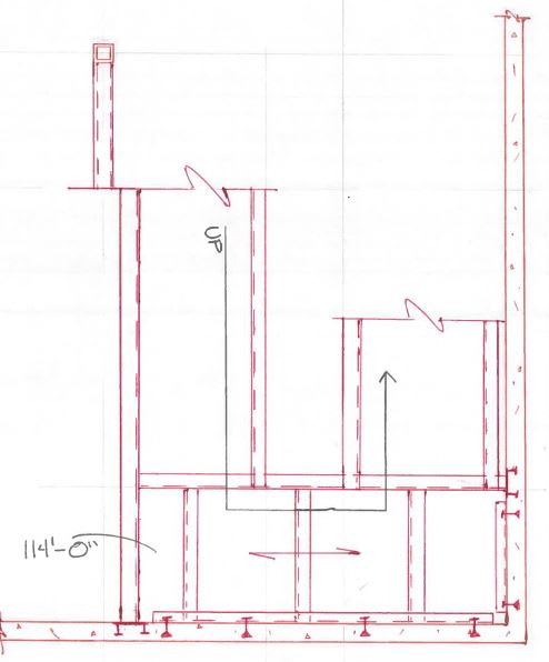

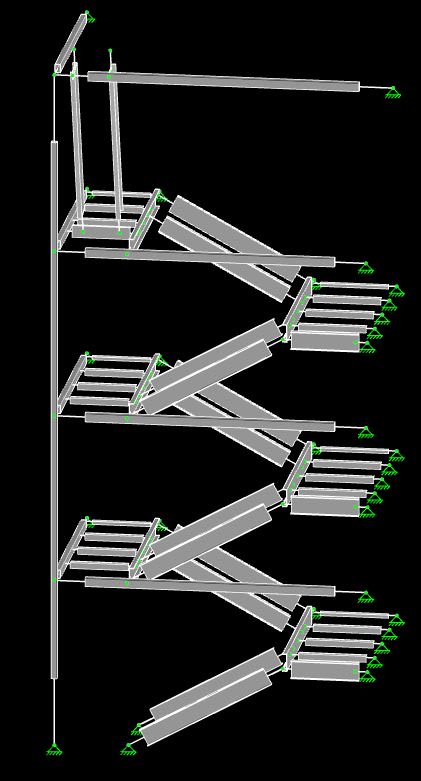

Here is a model and the corresponding sketches I used to develop some drawings. However, the way you draw them differs between offices.
**EDIT**: I left the sizes, dimensions, and details out because this was for architectural review, but that's how our office likes to display stairs. Only a reference and not, by any means, the only way of doing something.
