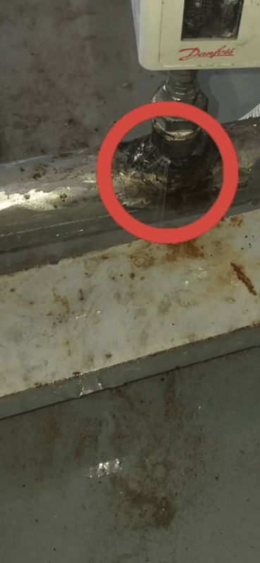

Hello,
there is on ss pipe in small RO plant which was not working maybe for 1 or 2 years now we are checking to restart this plant the proble in the ss pipe there is leakage in elbow and T our workers tried to fix with normal stainless steel welding rod 2 times but still leak coming also we tried to give to factory to do argon welding still same problem any one know a solution because we can not purchase new material right now we need to arrange leakage in same old pipe
It is likely heavily pitted on the ID and you are trying weld from the outside.
Look inside and see if there is any metal really left.What material is it? Are you sure of the alloy? Do you have the correct filler for that alloy?
If you are lucky there will be line or row of pits along the ID. You will be able to grind those out and then weld fill the slot that is left.
If the pitting is more widespread then replacing pipe sections is your only option.

So is the elbow / tee itself leaking or the weld?
What sort of leaking?
Any photos / drawing?
Can you get some UT on the pipe and area where it is "leaking"

here is photos
When you have something corroded like that you have to grind out the corrosion and in most cases the old welds completely.
Then you can prep, clean, purge, and weld.
P.E. Metallurgy
If that's Stl Stl on the brackish water side?? then you've probably got pitting corrosion going on.
The amount of weld on the elbow is unreal
The tee looks like a socket weld??
Is the elbow the same?
This is a strip down and rebuild job here. Just adding blobs of metal on the outside won't work.
Or just put a bucket under it.

I already give it back to the workshop and I asked them to remove all the old welding and corrosion and make grinding then we can weld again.
we will see maybe if they clean it good it will work the argon welding is stronger one.

I wondered about those, but many don't like being a leak plug, but more like a re-inforcement.
This needs something more than a plaster.
I think these are socket weld joints where the fluid has got into the socket and corroded it through.
With nearly a dozen leak points near the elbow and fitting, just replace the entire section of pipe and fittings. Just regular patching will not work
Absolutely agree with hacksaw.
Procure SS piping and plan for the complete replcament at the earliest opportunity. Hope the workshop guys are conversant with the material grade and filler wires required.

For who told me about new material, yes you have reason and that what i suggested but now it's very difficult to find material the majority of workshops and shops are closed and some industrial areas are closed also so that is why we are trying to fix without replacing for now.
What pressure is this system at that is leaking?
@LittleInch 17 bar
