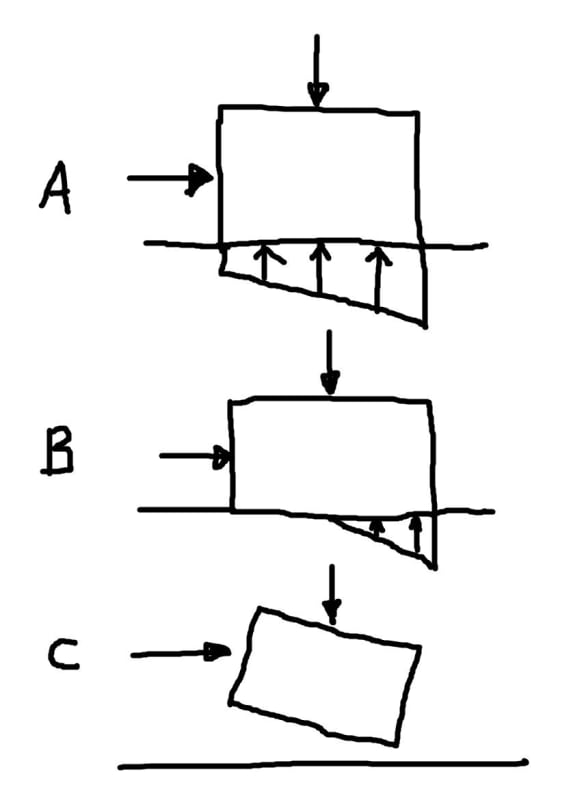

There seems to be contact between footings and superstructure along a certain width of the footing, so it seems that the case is B), not C). If this is not the case, then the other obvious answer is that the lateral loading is too big in comparison to the dead load, causing uplift.
Also, don´t forget to add vertical restraint to the superstructure-footing connection! You did not mention it in the first post. If there is no vertical restraint, the y-axis deflection may be nonzero.
PS. In all honesty, using pinned or stiff supports - not modelling the base as springs with subgrade moduli (which, by the way: is not a geotechnical parameter, is hard to estimate and can affect deflections a lot) - may be the more straightforward option. Then, only an overturning check and a sliding check (can be done by hand!) needs to be done to ensure lateral stability.
