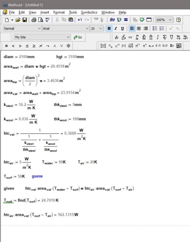

Dear All,
I would like to calculate heat loss of hot water stored in an SS 304 tank
Water temperature 90 C
Dia of tank 2100 mm
Height 3100
shell Thickness 5 mm
rockwool insulation 100 mm
K 0.036 W/m-k
SS 304 K value 16.2 W/m-k (this is at 100 C. I don't know K value at 90 C)
combined K 0.036 (1/(1/16.2 + 1/0.036))
I am referring this formula from
[link conductive heat transfer through a pot wall][/url]
This results in 3800 watts. screenshot of calculation attached
So what would be the heat loss in degree centigrade if the tank is exposed to open air for a duration of 10 hrs.
Thanks,
You appear to have used the K figure for rockwool, but the thickness of the steel.
for heat transfer use the thickness of the rockwool - 0.1m. your heat out will reduce a bit. Heat insulation of the steel is negligible so forget it.
Temp drop is a transient thing as the heat loss drops off as the temperature difference reduces.
You can do a simple calc by looking at energy of the water at the start then reducing it by the heat outflow for say 30 minutes as a flat figure. Then recalculate the water temp. So long as its less than say 5C you are good, but if higher then reduce the time period.
Then recalculate based on your new temperature as the heat flow out reduces. Rinse and repeat.
Note that this is quite simple and ignores any impact of air flow over the outside. It will probably conduct heat away at ambient temperature, but not if it is e.g. inside an enclosure...
So heat loss in the open air with a breeze would be different to indoors inside a room.
There is heat transfer from the fluid to the tank, then from the tank to the air outside. So you are missing 2 resistances that depend on if the fluid moves or not. But in your case you could assume still water and air. Obviously a warm tank would introduce some convection.
There are number of errors in the graphic. The area should be closer to 24 m^2. The heat transfer coefficient is incorrectly inputted, since your equation in OP ignored the thicknesses of the materials. The deltaT is incorrect, although close, since you neglected air convection
Here's my calculation
TTFN (ta ta for now)

It's a pretty big Pressure vessel, but 100mm of rockwool is also pretty good insulation, so 0.5kW heat loss sounds about right.
but location and air movement outside of the vessel could change in a lot. And if it rains.
With the tank being insulated, the wall thickness of 5mm will not create a significant temperature drop across the thickness of the tank even with all the factors mentioned by LI impact the vessel. Another point is temperature of water mentioned by IRs as 20K would exist as a solid and not liquid. Your biggest challenge is to determine the coefficients of convective heat transfer inside the tank wall and outside the insulation of the tank. Also in the calculations, I would use the bulk temperature of the water inside the tank which I would estimate to be an intermediate value between the inlet and outlet temperatures of the water. Be aware that the coefficients of thermal convective heat transfer on the outside surface of the insulation may not be the same between top, sides and bottom of the tank. Use the procedure presented by IRs but be careful about the temperatures in degree Kelvin in his presentation which is for steady state.
I was lazy and used K instead of °C, which requires more keystrokes in Mathcad; for heat transfer, it's all temperature differences, once you get past the heat transfer coefficient itself, which does use absolute temperature to get it right.
