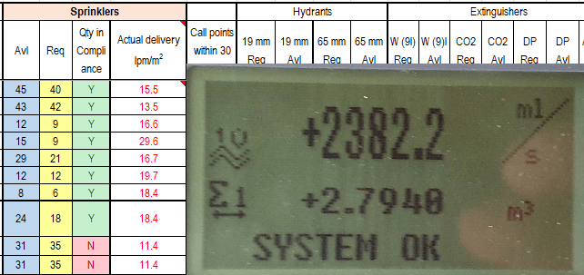

Individual flow, when tested after opening 8 sprinklers at the same time, the lowest was delivering 138 l.p.m. and with the number of sprinklers available, the floor has a density of 13.5 l/m2 minimum. (11.4 l/m2 is from a OH location)
