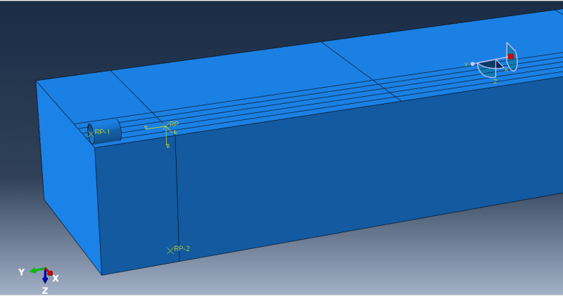

dear all,
I am simulating moving rollers with dynamic loads both in harmony.
Results:
(1) at position 5m, 20m velocity in the z direction is the same.
(2) when adding alpha, beta damping coefficient, the x, y velocity changes; velocity in the z-direction remains constant (1).
I am looking for parameters related to velocity in z.
Do you have any way about this problem?
Many thanks,
Hoang An

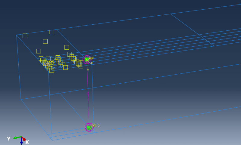

Can you attach more pictures showing where are the boundary conditions applied and where are the springs/dasphots acting ?
And what are the BCs ? It would be best if you could attach .inp file.
So the spring is acting between the two nodes on the top and bottom of the solid domain representing the road, right ? Is it supposed to change the compliance of the road ? I’m not an expert in road analyses but this approach does not seem correct for me. It should be done through material definition.

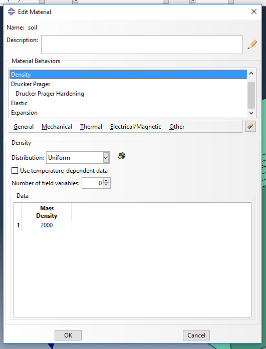

The material I added damping factor: alpha and beta Rayleigh, only works for velocity results V1 (x), V2 (y).
If so, what additional parameters do I need in the material to determine the velocity reduction V3 (z).
Many thanks,
You can try defining bulk viscosity but material (Rayleigh) damping is actually the one that should be adjusted.
Check the following references (Abaqus documentation):
- Example Problems Guide —> Mass Diffusion and Soils Analyses —> Soils analyses
- Benchmarks Guide —> Analysis Tests —> Soils analysis
You can find there several examples with detailed description, models (inp files) and of course material data including Drucker-Prager model.
Apart from articles there’s even a book „Applied Soil Mechanics with ABAQUS Applications” by S. Helwany that you may find interesting.
