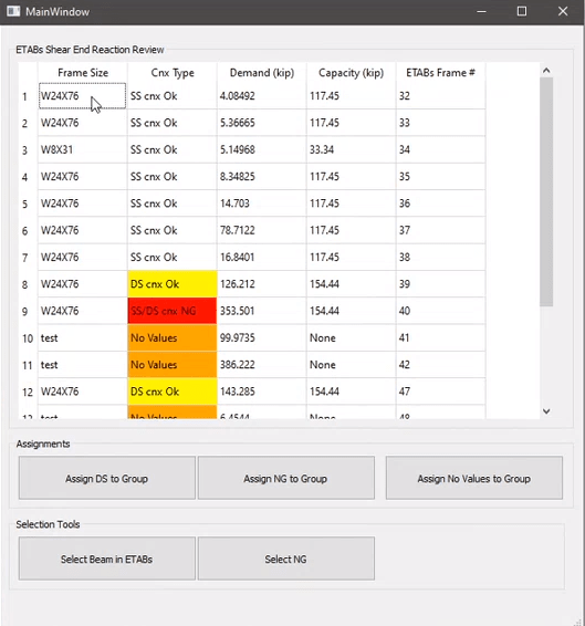

I enjoy writing code in python, but making GUI's for my code has been the bane of my existence.
I just recently made this GUI in python and it took the better part of 2 months to code (probably working 4-8 hours a week on it).
If I had done this in excel, I think it would have been a lot easier.
