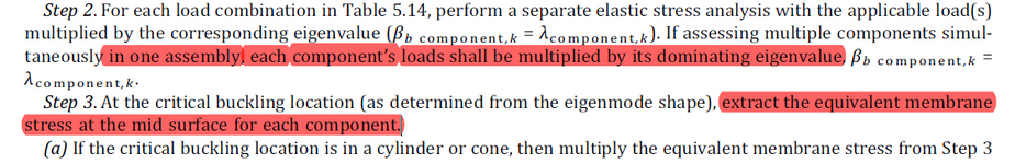

2. step 2 of method A indicates that "each component’s loads shall be multiplied by its dominating eigenvalue", i perform the eigenvalue buckling analysis for the components ( a cylinder with two heads) in assembly , the eigenvalue from ansys is for the assembly. it's not component-specific, how come i get the eigenvalue of each component ? must the eigenvalue buckling analysis be performed for only one component in a single time? if yes, such analysis must be performed for 3 time in my case, and i think the method is quite hard to apply in reality.
3 . how to "extract the equivalent membrane stress at the mid surface for each component."? is it a linearized stress which shall be extracted by creating a path in ANSYS?

2. You will need to request a fairly large number of eigenvalues/eigenvectors to get the ones for each component.
3. Yes, the membrane stress is obtained from a linearization.

2. @TGS4, could you elaborate on " fairly large number"? could the eigenvalue for the whole assembly (a shell with two head) be used as the "dominating eigenvalue" which to be multiplied with "each component’s loads"?
Thanks in advance, any reply appreciated.
1. That is the through-thickness stress - entirely predicted from thin-shell theory: the negative of internal pressure on the inside and zero on the outside. This will not lead to buckling. The focus is on hoop and meridional directional stresses. For example, in a torispherical head, under internal pressure, the hoop stress at the knuckle is compressive - this can and does lead to a buckling failure (you can see this in the design-by-rules for heads - knuckle buckling). So, it's not a stress limit, it's using your engineering judgement regarding which compressive stresses can (potentially) cause buckling.
2. Fairly large means enough to observe a buckling mode shape in each component. No, "the eigenvalue for the whole assembly", which I take to mean the first eigenvalue, cannot be used for all components. You need to find the eigenvalue for each component.
