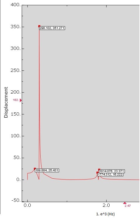

Dear all,
I have a new question about results from Modal analysis, after performing Modal analysis , I've done Frequency Regponse Analysis of the geometry and there is some thing still not clear for me. after FRF , there is graphics (Displacement vs Frequency.
I was wondering what is the units in this case, my geometry is millimeter scale(S.I (mm scale))and load is KPa. there are displacement in my graphics about 350 (???) vs 300 Hz. just wondering if it is not practical or sth else ?
Bet regards
Adil
If your geometry is in mm but load is in kPa then you’re using inconsistent units. Check the unit tables for Abaqus in the internet. When the dimensions are in mm, pressure must be in MPa.
Thank you very much for your quick reply. yes, your are right, I took Mpa as give in the Table below. what is the units I got for Amplitute in this case ? micrometer or millimeter ? Thank in advance
When using the SI(mm) system consistently, all inputs and outputs with length units are in mm.
