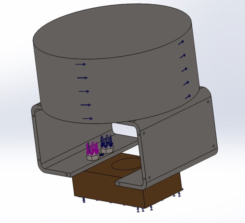

Hi all,
I run a FEA on an assembly and I am not sure if I can trust my results or if they are "polluted" by a singularity.
The top part, a gearbox generate a torque transmitted through some bolts an pins connectors to the folded parts, the Mounting Box. (Enclosed "Gearbox connection")
This mounting box is connected to a fixed body thanks to a pin connector and some 3D bolts. (Enclosed "Body connection")
My assumption is that the gearbox connection is rigid when the body connection can allow some movement under the bolts if the bolt preload is too low.
I applied a force on the top of the bolt to model the preload and I set a friction of 0.1 between the bolt head and the Mounting Box and between the Mounting box and the body.

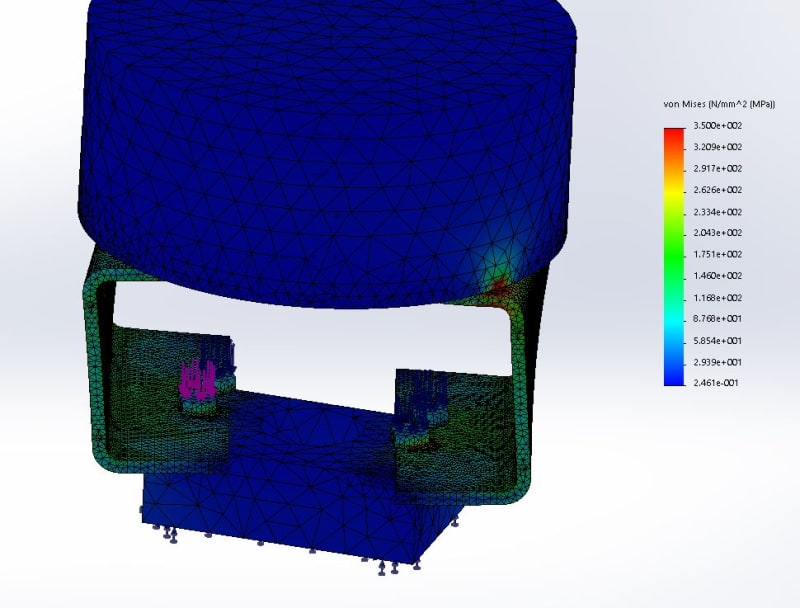

The assembly seams to deform as expected, when increasing the torque I can see some movement under the bolt until the box hit the bolt diameter.

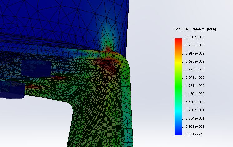

My problem is that I get very high stresses on the corner of the mounting box and I am wondering if I should worry about it.
I believe my simulation allow me to correctly plot the displacement but that the stress isn't accurate because of this singularity.
How can I get correct reading of the maximum stress in this corner?

Gearboxe connection

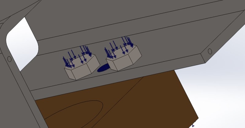

Body connection
Deformation
Stress concentration / singularity
A bit more information will be necessary so let me ask you a few additional questions. What is the interaction between gearbox and mounting box ? You said that you want this connection to be rigid but did you apply any contact between these two parts (be it bonded or no penetration) ?
Also is there a contact interaction between the bolt shank and holes ? What is the scale of the deformation plot ? Isn't it deforming too much ?
Can you show a picture with those pin connectora. I'm not sure where they are applied.
Finally, I would rather apply preload force on the part of the shank instead of the head but maybe this approach will work too.
The gearbox to mounting box contact is a no penetration contact (node to surface).
The Mounting box to body contact is a no penetration contact (node to surface) with a friction coefficient of 0.1.
No penetration contact sets (node to surface) under the bolt head.
No penetration contact sets (surface to surface) between the bolt diameter and the body bolt hole.
No penetration contact sets (surface to surface) between the bolt diameter and the Mounting box bolt hole.
Yes of course the deformation scale was 5 but the deformation remain quite large (around 3mm in X and Z direction).

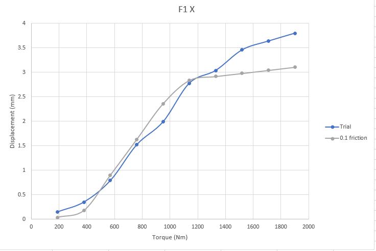

I performed a design study increasing the torque and I saw the model was acting as I was expecting.
Their is slow deformation until the torque is high enough to overcome the bolt friction.
At this moment the deformation increase quickly, the bottom of the mounting box is moving, until the Mounting box come into contact with the bolt.
The deformation goes slower after that.
I performed some trials on this assembly and I get very similar displacement.
In fact I used my trials to help me set the friction coefficient.
I am not surprised to see high stresses appearing but I wasn't expecting them to be that high.

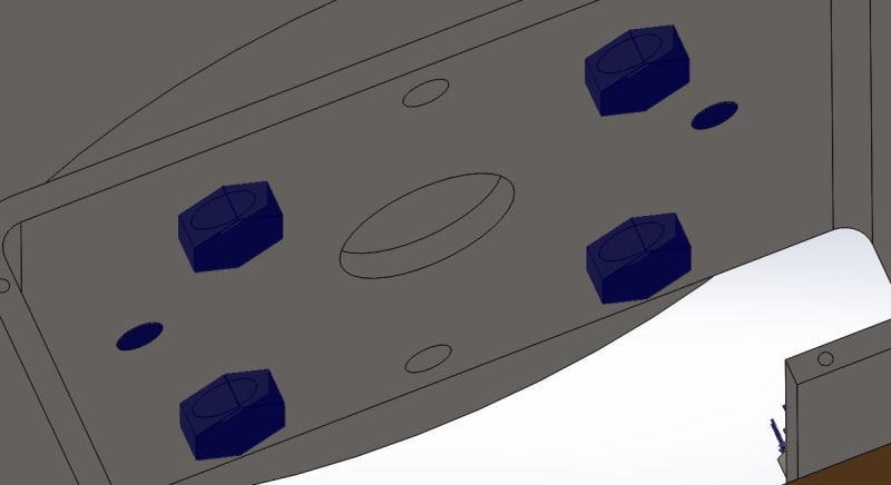

The gearbox pin connectors are on the same PCD than the Gearbox bolts.
The body pin connectors are between the body bolts
Make sure that there are no initial gaps between the surfaces in contact that the selected contact algorithm may not catch (most types of contact definition in SW Simulation can't handle initial gaps).
For me this stress concentration doesn't look so bad. It seems that the gearbox is deforming slightly downwards and touching the mounting box. Due to the torque stress concentration appears around the point of contact. Investigate the remaining concentrations that can be seen on the first results picture and try to determine their causes.
If stress is the result you are ultimately looking for I would consider refining the mesh. Working with two elements trough the tickness, I would use more. But it also depends on the element firmulation and perhaps you have higher order eleents.
I would actually use a plate model för this if I understand the geometry correct. Also, it should not be impossible to get a rough estimate of the stress level by hand.

I run additional analysis to try to understand if the stresses I get are true stresses or singularities.
I am quite sure they are singularities but it doesn't mean I can completely ignore them.
First, I run a convergence analysis and the stress seams to be infinite at the contact edges of the model.
Then, I run several other models playing with the gearbox dimensions and removing the gearbox (see file attached).
I believe the singularity appear as the corners of the box are moving upward and clockwise due to the torque creating a linear contact along the edge of the Gearbox (area = 0).
How can I get a true stress considering the mounting box / Gearbox contact?
Is it even possible?
Should I just ignore the contact stress by removing the Gearbox?
Thanks a lot.

Hi
What I noticed is that your peak stress has been reduced from 350 MPa (?) to 200 MPa.
I can only assume that it id a stress you choose in the postprosessor for the color scale. I would set it much higher. I want a location för the peak stress, a point, not an area.
Then I would remove the contact conditions but keep the bolts. Are there still peak stresses, and if there are, where are they?
Another test would be to set a yield stress and run a nonlinear analysis. How does the yielding effect the deformations?
Haw you checked the contact stresses? They can be very high in some situations.
Before assuming that it is a singularity I would look at the things I have now mentioned.
