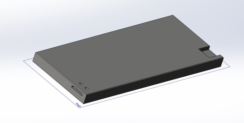

Here is an image of a simple part:

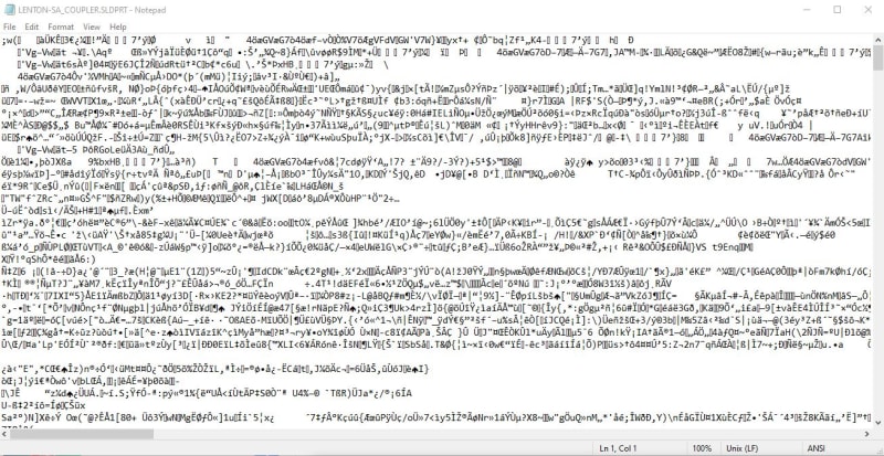

Native SW part file. Useless except to SW.
Exported to a step file, and listed in notepad: (923 lines in total)
I don't think either are useful. I am surprised STAAD does not take .ifc files. That works in many other packages.
Yeah, that's not the language the STAAD editor speaks.
