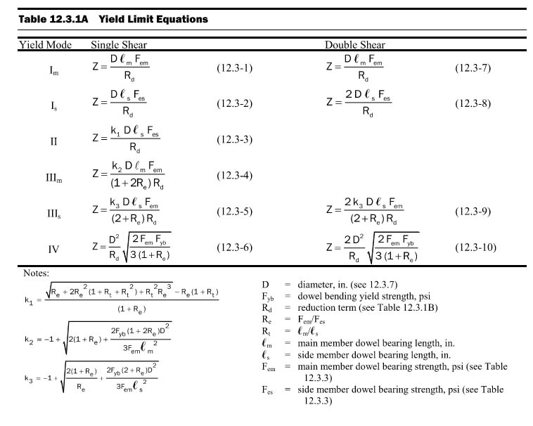

I don't work a lot with wood but currently have a project utilizing LSL rimboards beneath wood framed walls, some of which will be shearwalls. I understand the mechanics of the shear transfer from the wall above using 16d nails from sole plate to the LSL and from the diaphragm to the LSL via the diaphragm edge nailing pattern. Then at the top plate below I would have a framing angle (like a Simpson A35) to transfer the lateral load from the LSL to the wall below. My question is how do I calculate the strength of the 16d nails connecting the sole plate to the LSL? In looking at NDS 2018 Chapter 12, I don't see any tables that adequately reflect this situation (side member being sawn lumber and main member being an LSL). I have found proprietary information for this situation for screws such as TimberLok and Simpson, but nothing regarding nails. I realize this might be a dumb question for some, but I appreciate any help I can get.
Looks like I will be spending some time calculating the capacity the long and old fashion way, by hand for these equations. I just wasn't sure if there was a table someone had created. You would think the LSL or LVL rimboard manufacturers would include this in their literature as it isn't hard and they only have to do it once.
For lateral loading, you can treat it like sawn lumber. The manufacturers provide equivalent specific gravity values. LSLs are different for face and edge grain, I believe. So using the load tables/calculators that are available but selecting a species with a comparable SG should get you what you need.
I've found AWC's connection calculator to be a handy tool for quick checks.

Just a thought on your load path. The arrangement of nailing and connectors necessarily assumes that any sheathing between the bottom plate and the top plate is not participating in the lateral load path. Shear comes from the sheathing into the sole plate, then into the LSL, then into the top plate, and finally back into the sheathing below. I have generally seen that an exterior detail like that will have sheathing continuous over the edge band member. If you can put a little control on the horizontal sheathing joint (to say the top of decking), then you could eliminate the A35 since you could provide perimeter nailing from the bottom sheathing into the LSL.
