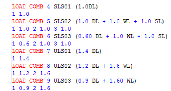

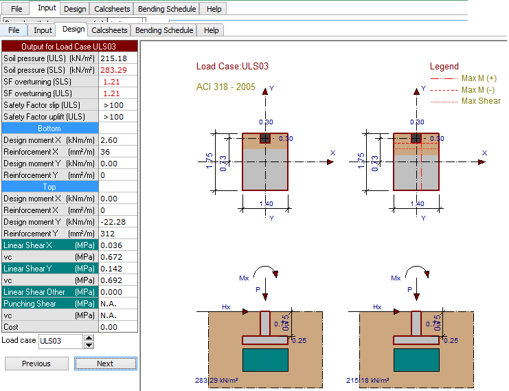

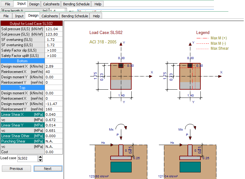

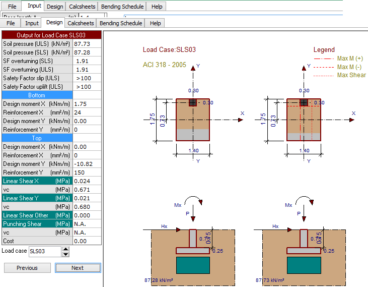

Hi all,
Anybody done Footing design using PROKON? I could not understand the calculation made by PROKON for ULS & SLS bearing pressure. It does not match with my manual cals. I just want to make sure whether my input in PROKON is right or not?
Thank you,
Prokon Input & output. Also here why the SLS pressure is greater than ULS pressure?
Support Reaction & Moments for load combination from Staad
