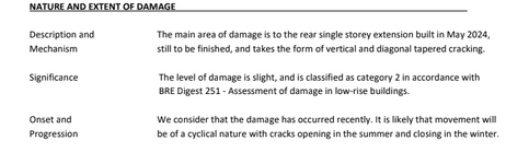

I would define "major sinking" as few cm drop and large cracks.
Below is part of the subsidence report where damage is classified as slight and I have few photos showing minor cracks and the wall ties been ripped off the existing wall.

If you are still getting rootlets at 2m depth then you are still likely in desiccated ground, which is prone to shrink and swell. Your shear vanes show 140kPa plus, your buidling control said the foundations are on stiff ground. It would appear that its a water infiltration problem. You could be suffering from the below statement. Just because you followed BRE doesnt mean you might not see movement. You seem to have been unlucky
