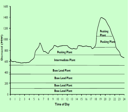

Aside security and costs, the technical limit I see for the nuclear share in the generation matrix is that its a baseload type of power plant. The intermediate and peak demand still has to be supplied by dispatchable generation as gas turbines and hydro.
What would it take to make nuclear ride those waves?
