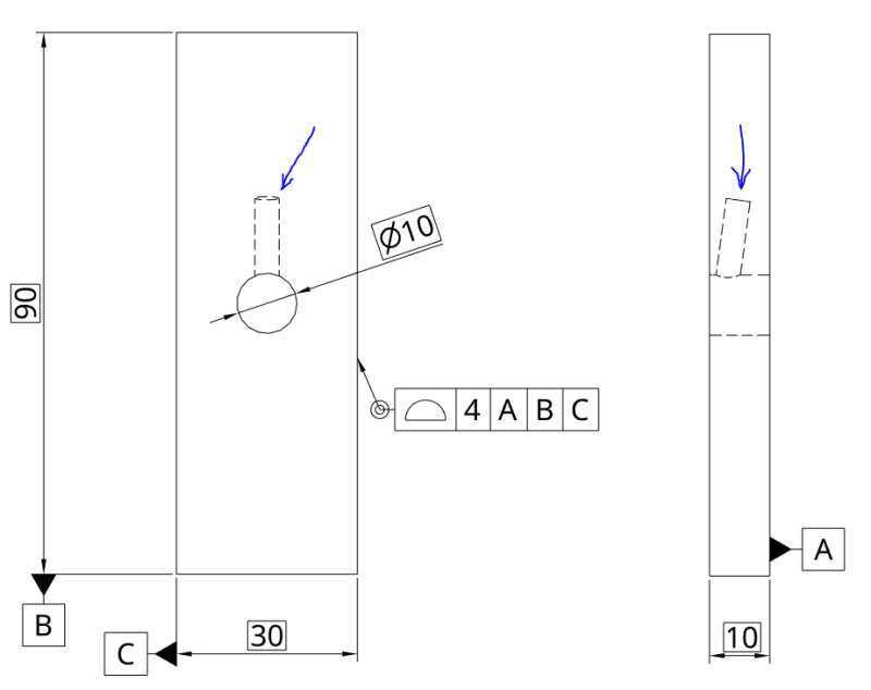

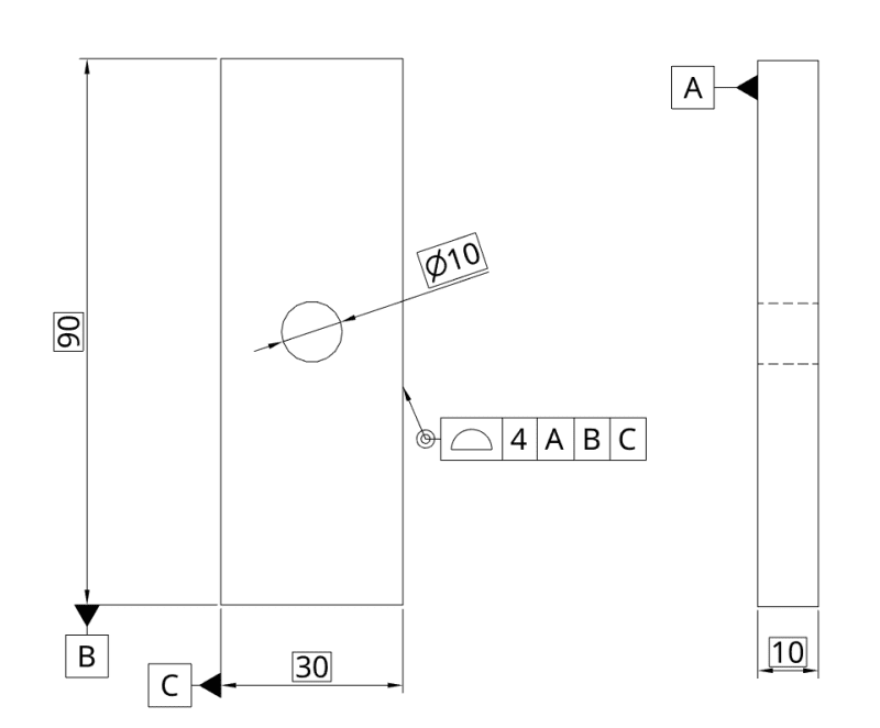

While I briefly looked at the topic drawoh linked, I questioned myself with possible solution, at least if it's ISO. (newer ASME doesn't like symmetries anymore, someone said)
Well, it's more like half-guess from me, mostly because I'm not sure if that "all-over" even covers the hole also?
cr7.... Yes, "all over" literally means all over (unless otherwise specified). So in your drawing you could even do away with the three datums and just have that all-over profile of 4 mm (you'd also need to know the Theoretically Exact Dimensions for the hole's location).
John-Paul Belanger
Geometric Learning Systems
Belanger said:
... So in your drawing you could even do away with the three datums and just have that all-over profile of 4 mm (you'd also need to know the Theoretically Exact Dimensions for the hole's location).
Thank you JP. Would all over cover also the blind cylindrical pocket I added?
I'm primarily interested if ISO allows it, but I'll assume that case isn't any different in ASME. (except for the symmetries)
Think of it this way: If you dunk that part into a tub of water, anything that comes out wet will be toleranced. So yes, I would interpret it as covering that extra pocket.
John-Paul Belanger
cr7, I think all over is more appropriate without datum references. The three datums in your drawing, I believe they contribute nothing to the geometrical specification and there is half the tolerance zone available for datum feature A.
I was thinking of "how would I measure this" with this drawing, but I can agree with what you are saying.
Sorry, can't see how that would be. Can you elaborate?
cr7,
Just to throw in a reference as I recently discussed this, the effect on both FOS and non-FOS toleranced features which are also referenced as their own datum features (I like to call this self-referencing) was discussed on another thread with similar callout (all-around though instead of all-over, the concept can be extrapolated).
This of course assumes an ASME interpretation (and is codified in the latest 2018 version). I'm not sure what the ISO practice is for such a reference, however it may be similar.
Thank you @chez311. After briefly reading through thread of which link you provided, I get it. (I imagine it like: if your datum is "sitting" on outermost points, there of course will be no more points in that direction, so it makes half of tolerance there ever "empty").
Which makes a lot of difference if I would put that datum A on a symmetry plane. (or more like symmetry of planes, I know, my expression of terms might be off by a lot)

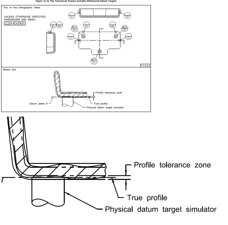

chez311,
A crude rule of thumb is that tooling should be about ten times the accuracy of whatever they are producing or measuring. This really ought to go for datum features. If I were doing something like this, I would consider datum targets. I understand this is fairly standard practise for castings.
JHG
cr7,
The gist of it is essentially a planar datum feature simulator is coincident with the true profile. For an equally disposed profile tolerance, where the tolerance is equally disposed on either side of the true profile, only half the tolerance zone is usable since only half is on the usable side of the simulator where the part material is. For a unilateral profile tolerance the entire zone is available since the entire zone is on the usable side of the simulator/true profile.
drawoh,
Yes I would agree this is more common with datum targets on castings/molds. In that case since the simulator only contacts a point/line/limited area the portions between the targets may utilize the entire zone while the localized portions which contact the simulator are coincident with the true profile. See Y14.5-2018 fig 11-22.
