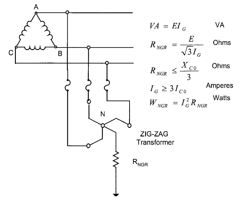

I have a 10MVA 33/4.16kV Yg/D transformer, X=5%. What is the phase-A SLG fault current on secondary delta? I think it should be zero as the transformer zero sequence is open and then there is no current is passing?
If a zigzag transformer is to be installed with x0 = 5%, how to compute the new SLG fault?

The fault is in phase A at the 4.16kV - it is outside the delta (i.e. downstream the transformer secondary delta side). I believe there is no SLG fault value as the transformer won't pass the zero sequence. If you think there is a SLG current value, what value it will be?
If a zigzag transformer is to be installed with x0 = 5% downstream of the transformer delta secondary, how to compute the new SLG fault?

Z1=0.05 p.u.; Z2=0.05 p.u.; Zo[of Zztr]=3*X1=0.15 p.u.[usually]
I"k1=sqrt(3)*1.05*4.16/(5*0.05)/Zbase[IEC 60909-0]
Zbase=4.16^2/10=1.73
I"k1=sqrt(3)*1.05*4.16/(5*0.05)/Zbase=17.487 kA
IG=3*I"k1
IG=3*17.487=52.45 kA for 10 sec.
Inzz=3%*IG=1.574 A [IEEE 32/1972]
P=Inzz*VLG/3=1.574*4.16/sqrt(3)/3=1.26 MVA

The only remaining question shouldn't the SLG fault current at the delta side zero as the transformer does not pass zero sequence current. Why did we install the zigzag, Is that for reducing the voltage LG as it went to sqrt(3)* VLG? or because we wanted to detect the SLG fault? why we need to add this zigzag transformer?
For delta connection the SLG current depends on the capacitive reactance of the load-including supply cables and overhead line. This current is low and a protection relay is not enough sensible to act.
Usually an ungrounded neutral system is able to function with one phase grounded. The voltage between the ungrounded phases and the ground will rise up to between phases voltage that means 73% more.
The system may function so for short time[seconds] or limited duration [usually up 1 hour] or indefinitely.
That depends on many factors: requirement of unbreakable supply on the consumer part and the system insulation possibility to withstand the overvoltage.
Usually a low resistance grounding will cancel the overvoltage but high resistance grounding may be enough sometime.
In your case –for instance-a 100 A resistor Rn=4160/sqrt(3)/100=24 ohm.

The zig-zag transformer provides a symmetrical ground connection for an otherwise ungrounded system.
You may also provide a symmetrical ground with a small wye/delta transformer bank.

To size the ZZ transformer donot you need the total zero seq capacitance (XC0) of
the system?
Sorry for the delay, Kiribanda.You are right. You have to verify if the current you calculated [Inzz] is not less than Ico.
