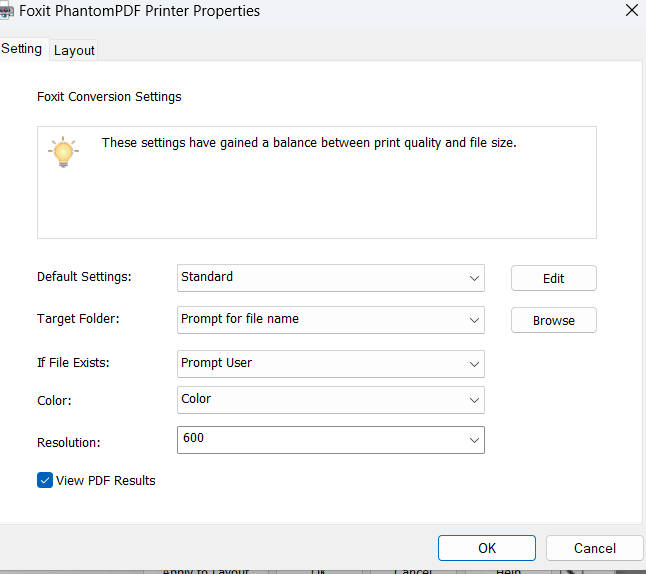

So On my ACAD viewer DWGTrue view, when I ask it to print to pdf and then hit custom properties this menu appears and in resolution there are options.
Anything less than 200 or 150 will probably look terrible, but the file size will be much smaller.
Much appreciated LittleInch. I the CAD files so I played around myself.
Reducing the size of the page to 24x36 reduced the file size 8%.
When adjusting my printer settings, I had 2 options to change dpi for: Vector Quality and Raster Image Quality. I was able to change both all the way down to 150dpi without changing the quality of the pdf and got the file size down a further 31%!

My version of AutoCAD has a "DWG to PDF" printer. It typically produces smaller pdf sizes than other pdf printers available. Not sure if its an autocad printer or something I installed ages ago. Actually, I just tried a small file using "Adobe Smallest Size" and got a significantly smaller pdf size than the dwg to pdf. We don't use batch plot or anything like that, so might be more complicated in that case.
Thanks I was able to automatically reduce file size by 30% then if I decrease the dpis to 150 each then I am at 48% of the original size. So far the best results! I am home by now and will have to try to print it tomorrow!
