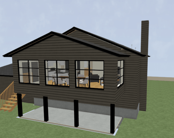

Hi everyone,
I need to open a gable end wall with an existing vaulted ceiling to include an existing addition within the open floor space (it is currently separated with the old house exterior wall). I have already sized the beam that will be required to support the roof beams. That new beam needs to be flush with the addition ceiling, which is a standard 8’ flat ceiling, as per the picture below:
Now, I assume this vaulted ceiling may be a retrofit, as the current gable end framing up top is made of a gable end truss (2x4’s on the flat) such as the picture below, instead of 2x4’s at right angle with the wall face:
Where I’m a bit in a pickle is how am I going to support that gable end truss without modifying it (I prefer not modifying trusses) ?
What I was thinking is to sister my LVL beam next to this gable end truss and bolt a steel right angle on its side to it to support the truss. I did not like the idea to rely on nails or screws through a 2x4 bottom chord:
Anything I’m missing from a structural standpoint?
I would still nail/screw the end truss to the LVL from the side through the bottom chord for lateral movement, and through the steel angle in the bottom of the truss as well.
Am I pushing this too far? Should I just nail the truss (bottom chord and webbing) to the LVL without the steel angle?

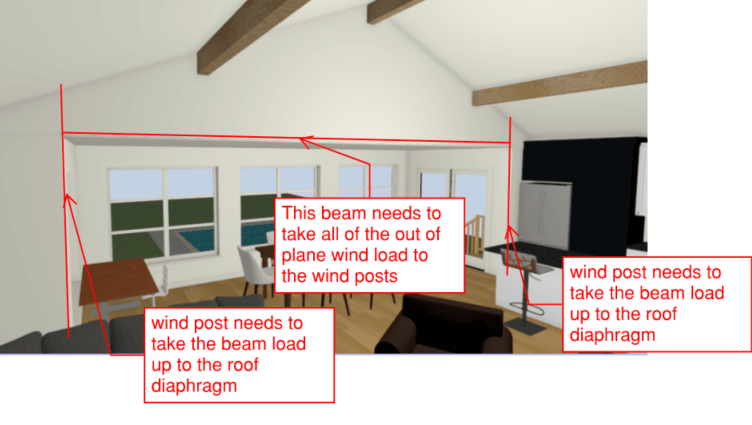

I'd be less concerned about the shearwall or the gravity honestly. My concern would be out of plane wind load. You are going to need some fairly substantial wind beam at the top of window and wind posts at the sides of the opening.
You haven't indicated any real sizing, but supporting that much roof on an opening of that size will need a substantial beam as well for gravity loads.
Hi jayrod12,
The roof beams in the picture are existing triple 2x10's and are only supporting 12' of the building's roof, with the rest of the house being trusses. Even so, the beam would be a double 18" x 1-3/4" LVL, so pretty substantial in fact due to heavy snow loads around here.

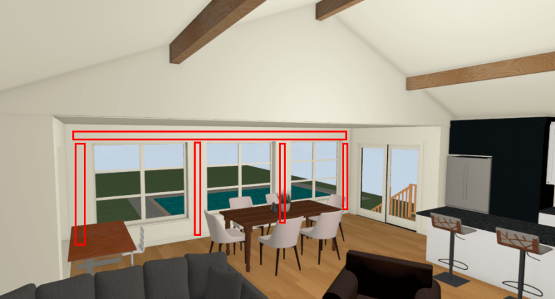

As for the wind beam and posts, I assume you are refering to the framing members on each side of the windows as shown in red below, or something else?
If so, to be honest I haven't really looked into that as the addition is already existing (built in the 80's) and doesn't show any sign of structural issue...I will still have a quick look at the perpendicular wind loads just in case.
I have edited my initial post, as I just read it again and saw that I refered to a "new addition" whereas really it is more knocking down the wall and make that addition part of the open floor plan.
I kind of mean those red members, however you have to take the out of plane wind loads up to the roof diaphragm.
Also, a 2 ply 18" deep beam really isn't that substantial of a beam. But I'm not running any numbers.
Remember that due to the size of this opening, deflection will be the kicker. And code minimum deflections are still visible on an opening of that size. I can't count how many times I've been somewhere with openings like this that look like they're smiling. Do the beams meet L/360, sure, but L/360 on a 20 foot opening is almost 3/4 of an inch. Seems small, but trust me your eyes can see it.

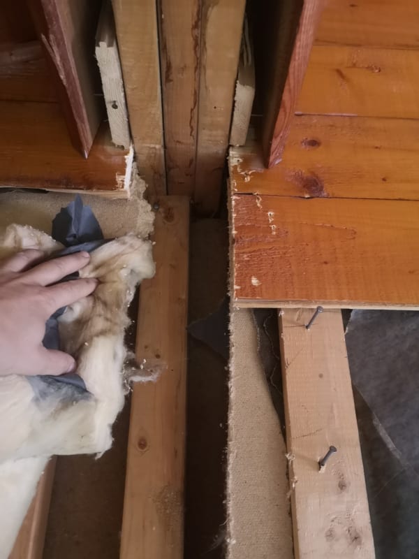

I went to the site today to see how everything is built now that walls and ceiling are being stripped down for this renovation...It is actually quite alarming to see how this was built back in the 70s...The 3 roof beams (triple 2x10's) are each supported only by a 2x3 on the flat (which has bowed toward the interior), barely toe nailed to the wall top plates:
Also, the addition walls that are perpendicular to the main building are not even tied to the actual framing. There is 1/2" space between the first stud of the addition and the old sheathing of the house. This definately needs to be fixed!
