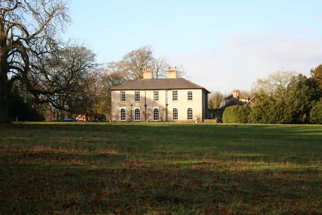

Arp32
- Aug 13, 2016
- 19
I've included a switched ceiling mounted ventilation fan in laundry rooms for as long as I can remember. When I first started designing homes, plan reviewers redlined me for this requirement and I never questioned it.
A contractor has recently pushed back at me on this, saying that the 4" exhaust duct from the back of the clothes dryer *is* the required exhaust ventilation for the laundry room, and a separate ceiling mounted fan & duct is not required.
Reading M1502. I don't see it calling for a separate fan and duct. Is that a requirement coming from somewhere else in the code, or have I just been calling out extraneous fans for years?
-Jason, Architect
A contractor has recently pushed back at me on this, saying that the 4" exhaust duct from the back of the clothes dryer *is* the required exhaust ventilation for the laundry room, and a separate ceiling mounted fan & duct is not required.
Reading M1502. I don't see it calling for a separate fan and duct. Is that a requirement coming from somewhere else in the code, or have I just been calling out extraneous fans for years?
-Jason, Architect
