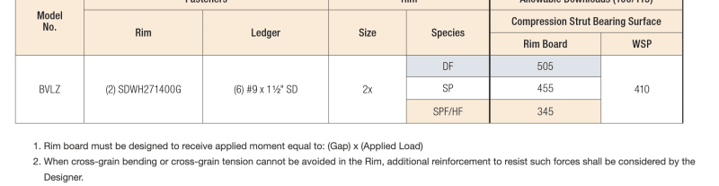

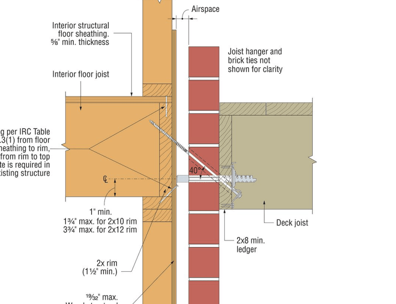

So trying to use this on a project. Gotta love the CYA... How is the dimensional lumber house band shown going to resist cross grain bending due to the applied couple? I hate when they do this.

kissymoose said:because our Simpson overlords say it's fine.
I wonder if they are trying to show that in the pic? Almost looks like the screw in entering the joist.phamENG said:Align them with perpendicular joists or blocking?
Oh wow, that's awful, I hadn't noticed that.XR250 said:But they actually say it is not fine in the footnotes
