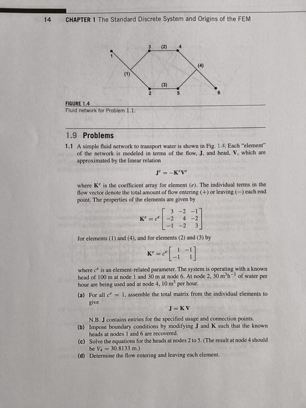

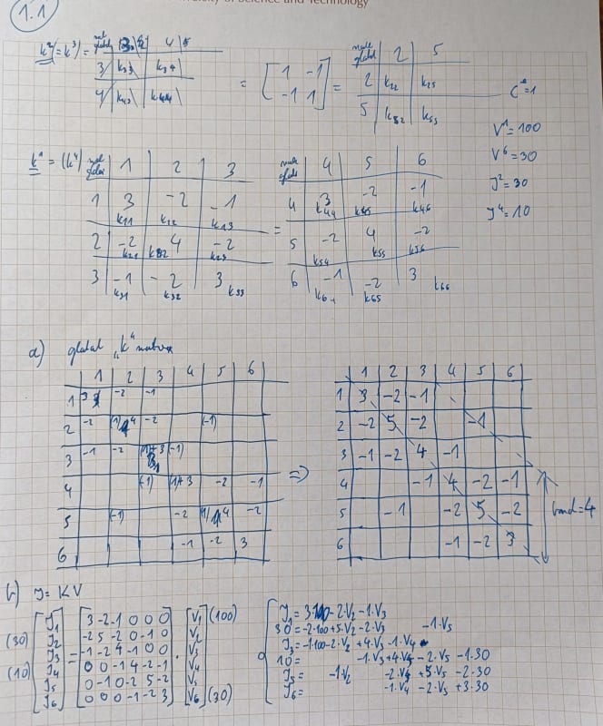

unfortunately I have some problem with exercise 1.1 from Zienkiewicz FEM vol.1 book. Could someone please take a look and correct my calculcations?
open points:
- in global matrik K should J2 to J5 be set up to 0? (due to the fact that inlet and outlet for these nodes globaly is equeal)
- am I corretly build global matrixes?
- could I assume that: J1=-J6? V3=V4? V2=V5?
I will be really thanksfull if sb could provie calculcation to the moment when V4 achieve right value.

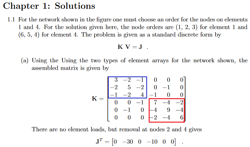

Have you seen the "Problem Solutions" document for this book ? It can be easily found online and this exercise is the first one discussed in it.
unfortunately, I cannot find on the internet mentioned by you "Problem Solution" document. Could you please send a link?
Thanks in advance
It’s hosted on Elsevier’s website but I’m not sure under what conditions. Anyway, if you search for "Finite Element Method Zienkiewicz Problem Solutions Elsevier", the first link in Google should point you to this document.

Sth bothering my in the solution posted in mentioned by you book. Could you please take a quick look? I guess it's sth simple.
-> why the multiplay k4 during transporting value to global K (red part)? (from my point of view value for red square should by the same as blue one, like in my first post).
