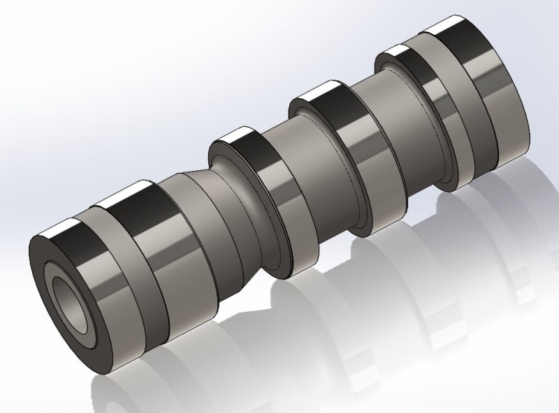

Any suggestions on how best to control the six ground diameters of a shuttle valve piston.
The perfect part would have:
1) all the diameters exactly the same
2) all the diameters concentric with each other
Thoughts:
1) let one end be datum A, the other datum B and a callout for total runout of each surface relative to A-B
2) continuous feature (but not sure of the details of how to apply)
3) one end be the a single datum and all other surface either controlled with total runout or true position
Not a lot of experience with multiple boss precision shafts and thought or direction appreciated

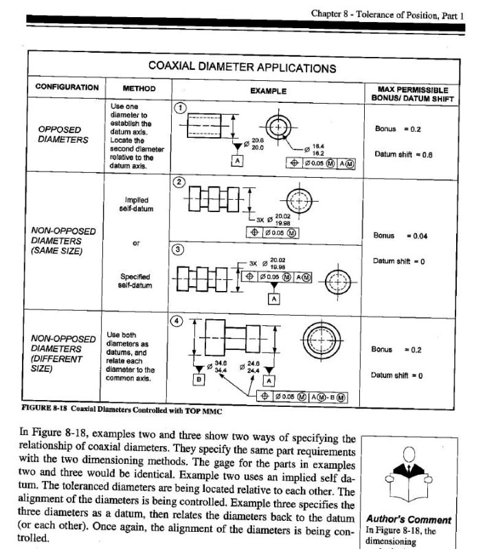

Something to consider:
Thank you, that is the image I was looking for but could not find.
Is that from Alan Krulikowski's book (which I don't have with me)?
If as you say all 6x diameters ride together on the same surface, then I don't think choosing one or two of them as a datum feature to control the rest is a good idea, and it doesn't reflect design intent.
My vote would be for a continuous feature <CF> callout. Alternately control of coaxiality of the diameters could be achieved with something similar to Y14.5-2009 fig. 4-24 wtih position. I believe these two would achieve a very similar end result with minute differences.
Note that use of <CF> has been expanded in the 2018 version as the committee has realized it is a useful control.
Just to add to the case for <CF> in your application you may want to control form more tightly across all 6x diameters together (instead of individually), especially since they all presumably ride on the same surface. <CF> combined with cylindricity will allow you to do this, and I think its a better solution for your application than position.
