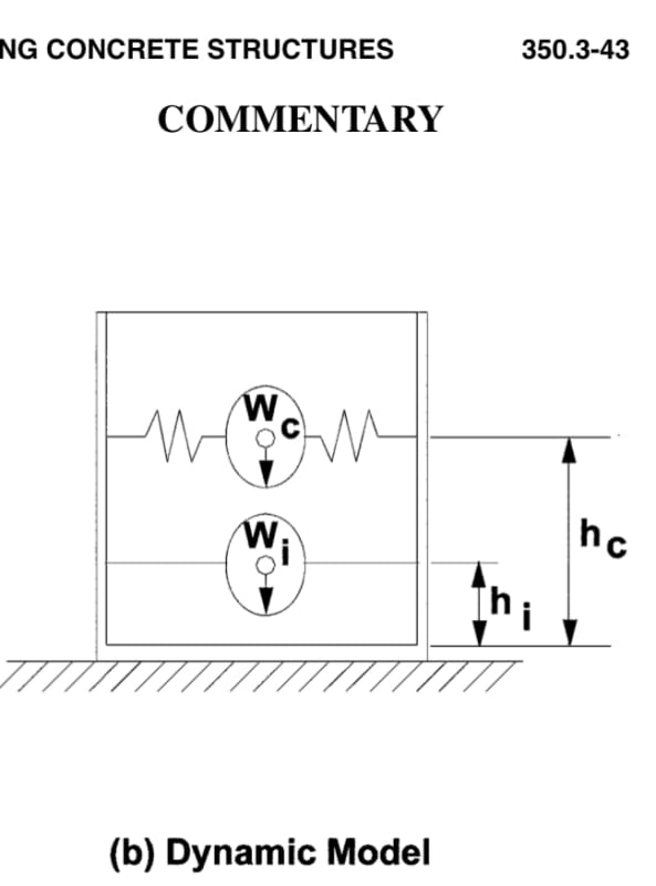

This graphic may help. Note how the impulsive component is idealized as a mass rigidly connected to the tank wall. The convective component is idealized as a spring that can oscillate.
Section 15.7.10.2 above is instructing us to ignore the convective component and consider the entire water volume to be rigidly connected (i.e. 100% impulsive), unless certain conditions are met that permit you to consider convective component effects.
