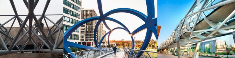

The images were picked up from the web in a random search. I think they're beautiful. Do you think they might have, or if you had designed them, would they have included drain holes to allow water to escape? Or would you have them completely sealed?

I would always advise to cap and drill weep holes.
Even minute openings will result in trapped water inside over time.
As these members heat and cool each day/night there is no avoiding it.
Just be careful that the drain holes are actually at the bottom and that they drain to someplace acceptable.
Never leave it open. Some type of tiny animal can access it.

The sealed pipe structures look good, but are they collecting water and rusting from the inside?
Open-ended pipes allow air to circulate, which may become wet and then dry. But have you seen how much condensation forms on cold surfaces? Condensation probably occurs inside those pipes where the air is free to move. Are they rusting faster than the sealed pipes because of the sweet fresh air that gets inside them?
