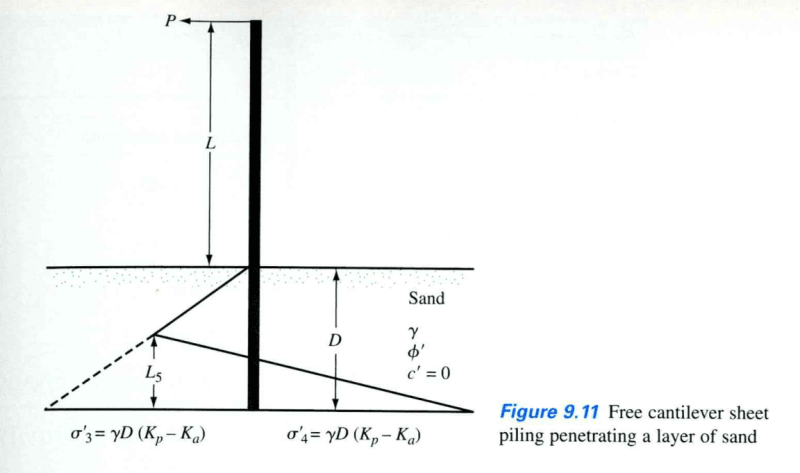

We have a 8m deep excavation in sandy soil, as per design we need to provide two levels of bracing. At top level (at 2m depth) we are using Deadman anchors. However, for 2nd level (waler is at 5m depth) our client is asking to install the H-beam in front of sheet piles so that load can be taken by the vertical H-beams. This is to safe the space inside excavation. We are not allowed to install the ground anchors. So now I have to do the Vertical beams calculation but I am unable to find any calculation related to this, can any body please help. I am attaching one schematic drawing for under standing. I need the calculation for H-Beam (blue color) in drawing.

Update. I used the approach in Das Foundation engineering book for the cantilever sheet piles without any backfill and apply on this h-beam but the moment is coming so high that I have to apply very big section at 1m spacing.

Thanks all of you for your input. We do not have free space inside the excavation for horizontal or raker bracing that is why this vertical beam is under consideration. I am also attaching the image of the concept I am refereeing. Actually we have use this method in one previous excavation but just based on experience by our team.
Khurram Shehzad, good luck with that design! The sheet piling and the soldier beams would be pushing on the same soil for passive resistance. I am not sure how you will model that unless you assume that the sheet piling has no embedment (this simplifies the analysis) and the soldier beams have about 3 tiers of horizontal walers against the sheet piling. Without even considering any surcharge loads and using average granular soils and no ground water, I get very large soldier beams at 1m spacing. With 3 levels of bracing, the sheet pile size needs not be very large. I assumed a trapezoidal earth pressure on the sheet piling. You could reduce the soldier beam size if you assume a triangular loading on the sheet piling but with 3 levels of bracing and some pre-loading of the soldier beams and walers, I don't think triangular earth load is appropriate.
