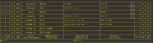

Is there any way to get the sheet location of a part/assy to show in a repeat region?
I can get the zones.
How did you get the zones to show in the repeat region?
OK got it. Put a view using a blank part where the bubble you want to call out in the bom is. In the region make the sheet & zone columns comments. Add this text to the rows: "&sheet:view:002" "&pos_loc:view:002" respectfully.
with the 002 as the name of the view placed earlier
Can you post an example pic of table ?
pic of bom
Here you go

Thanks for the pic.
One question: Is the &sheet a parameter with-in the part or assembly that requires manual input ?
We tried something like this years ago but the sheet number could not be automated then, maybe you have found a method. :confused:
It runs off the grid of the format. You have to set it up in the format. The zone also

We use drawing templates. Should I add the grid to the format used in the template or add a grid to the template ?
Also- Are there any negative implications of using drawing templates when using these location parameters that you are aware of ? Thanks again for your time.

grid is added in the template, shouldnt bother any thing else. sorry to take so long
