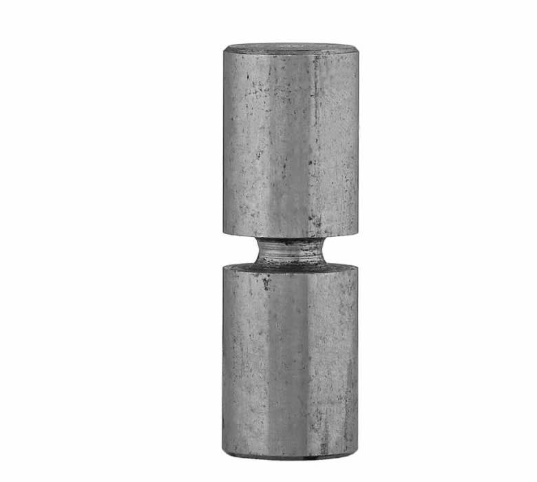

Hi all,
I have been searching, fruitlessly, for good practice guidelines when it comes to shear pin design and the ratios to set the pin OD and shear dia to. We deal a lot with retrofitting solutions, so unless I can persuade the client to bush this particular lug the OD of the pin is set. They want to change the material to 4140 from bronze, which would be a good choice but the increased strength means the OD to shear dia is a big step change: 35mm down to 14.5mm. Eyeballing this it looks too pinched for my liking, but I can't find anything that gives guidance of maximum ratios for setting pin dia to shear dia.
Are there guidelines that people stick to? Or could you have a 75mm dia pin and a 15mm shear dia and there are no adverse effects?

The important part is the shear diameter determined by the desired failure shear. I would think the pin diameter has no or little influence.

Ditto on hydtools's guidance: you should size the pin based on the required shear load plus a design margin (safety factor). The design margin may be dictated by standards/requirements of the industry or application, i.e. human vertical lift/life critical. Choose your material to match the shear strength requirement and environmental conditions.
Is that groove in the middle of the pin to 'force' a particular failure to cause failure load to be a more defined value?
The shear diameters will vary inversely as the square root of the material shear strengths for the same shear failure load.

Size the pin to accommodate the range of shear values that the hub is designed for. If this pin is being inserted into a coupling/flange/sprocket/etc. then bore the same pin hole diameter and turn down the shear diameter. This way you only need to stock one shear pin rough stock, instead of several. Of course, if you are providing shear pins for a wide range of couplings, it would be wise to choose a couple of pin diameters.
Thanks... I didn't know that shear pins have a 'notch' all around like
Is the shear diameter the diameter of the 'notch'? and is it's purpose to force a 'brittle' failure that is more easily calculated?
Is the pin intended to be a "fuse" to fail at a defined load level (within a range, not higher or lower)? Like a fuse pin on an aircraft engine mount?
To me the only purpose of the reduced diameter area is to provide a fuse function; otherwise just make it a straight pin.

@SWComposites @Hydtools, yes this is a fuse pin to prevent overload being transmitted into an expensive, safety critical, section of the machine. The shear dia will indeed be set based on the critical force at which the pin needs to undergo brittle failure to save damage further down the load path, in the same manner as an aircraft fuse pin in the undercarriage/ engine mount arrangement etc. What I am hoping to find out is if the ratio of shear dia to overall pin dia has a tipping point, or is any ratio acceptable with no adverse effects. Could you theoretically have a 200mm dia pin with a 20mm shear dia, for example and nothing unexpected occur in-service, or is there a general rule of thumb that says you should aim to have this ratio as 0.3 < ratio < 0.5, or something of the like? Or thinking about it is it simply what is practical in terms of machining and getting an suitable finish in the neck radius to maintain the shear force it will break at that limits the step change?
It would seem that pin diameter to shear diameter would determine a practical groove width to machine so that the length of the reduced diameter does not create a length getting the failure feature into a length that creates a failure in bending mode rather than pure shear.
An observation: a 4140 shear pin may cause more surface damage in failure than the bronze material. Just a thought.

We used pins in double shear and made out own (Ni alloy).
We selected a smooth OD to be about 33% over strength and then used the groove depth to tune each lot depending on the actual mechanical properties.
We liked the grooves to be ~10-15% of the OD deep and the width was about 2/3 of the depth.
We found these grooves to be very reliable.
Ed... what is the profile of the groove? Does it have a rounded bottom, or is it a V-notch. I can see the rounded bottom having better fatigue resistance (if needed) and the V-notch having a better controlled load capacity. I don't design them, I'm just curious.
Cautionary note - be careful with sharp notches as these pins can be subjected to stress reversals and fatigue crack growth, also use a relatively good finish to avoid crack initiation points. Further point, a larger shear diameter to pin diameter allows for a bigger/better radius to avoid stress concentration near the shear diameter.

They were full radius, anything sharper was unpredictable.
Thanks, Ed... gathered that from dvd's comment... narrow rounded bottom is likely the best.
